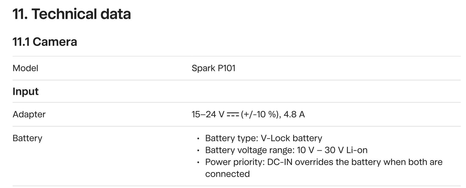

Does anybody know what the max voltage is the camera can take? 24V feels weird as a charged 24V battery would be +25V.
Can somebody confirm that 26V is safe?
The user manual states we can have up to 30V from a battery.
Damn how did I miss that? Thank you!!
