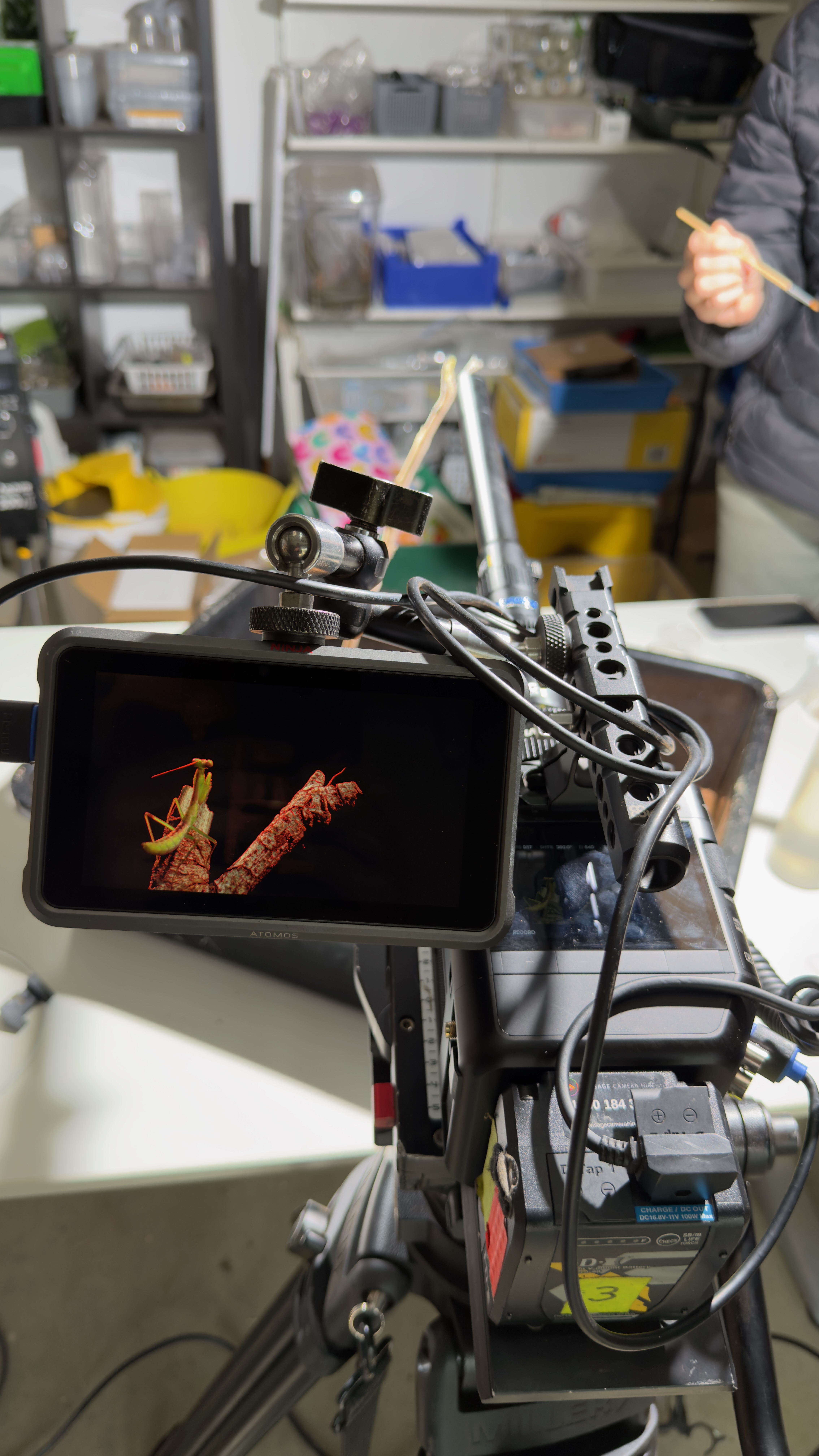

When testing I used the Laowa T8 along with their 0.7 focal reducer (AKA Speed Booster).
I ran an Aputure 600D bare bulb as key and then a 300D with fresnel as backlight.
Unfortunately there wasn’t enough light to stop down for a deeper depth of field so I stuck with T8.
You’re going to need a ton of light if you want to shoot 1000fps+ with a T8 lens.
For my test - more light would have killed the bugs, it was warming the stick up a lot.

I had my lights relatively close (inside 1meter) but as I said - heat was the challenge when dealing with the insects, it would smoke them if I went closer haha.
Thanks for updated clip links!
It’s interesting that you had focus peaking on your monitor, but praying mantis does look out of focus, while the fly is more in focus.
This shows that filming moving subjects might be extremely difficult at higher fps especially when you need to stop down the aperture.
