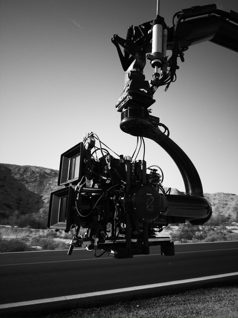

This week I had a chance to test two SPARKS on a proper production for the first time.
We were running in Baja Mexico at +104F/40C, brutal sandy conditions.
Here are the thoughts.
  1. Somehow powering with the SPARK with a 6S Lipo for FPV did not work.  The camera would randomly stop recording or freezing. Pixboom had assured me that 24V+ 10% should work perfectly fine but we ended up flying a small V-Mount battery instead.
  1. I was running SPARK and Venice 2 on a Flighthead for our arm car work, which worked well but not having a setting read-out or even more importantly a record indicator was infuriating.  As the camera was bagged it was close to impossible to see if it was actually recording (triggered via Preston and 3 Pin Fischer on the Mutinty Power IO)

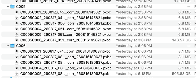

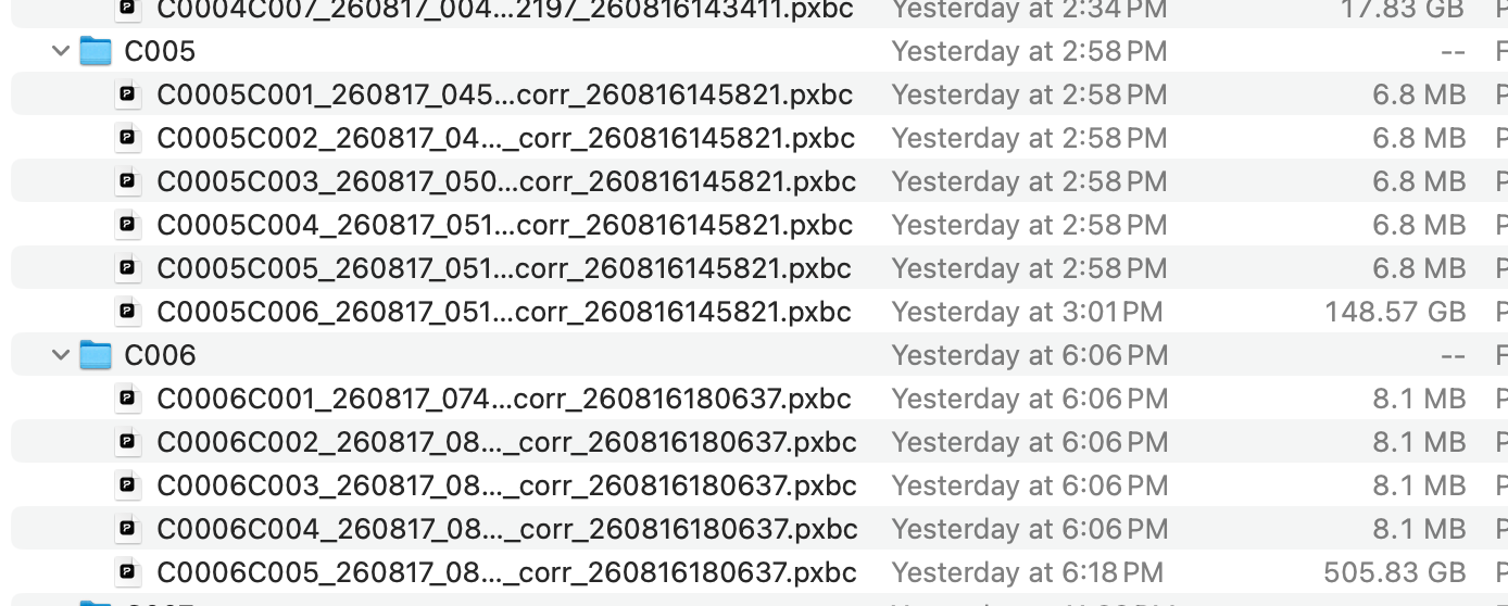

6)  Lastly an odd one: one camera shows a bunch of single frame DNG pxbc files across two cards. Still not sure what happened there - curious if anybody else has seen this.

With regard to the extra files - my touchscreen is touching itself and triggering run/stop randomly, mostly very short clips of only a few frames but I did shaft me yesterday when it run but didn’t stop and chewed the whole mag. I had to stop shooting to dump it.

I thought it was just me… Didn’t have run stop issues… But it seems like I’m jumping into sensor and fps options by itself sometimes…
Interesting - now that you are saying it. I do remember an issue with the camera being bagged and trying to see the settings through the bag.  Basically, the bag touching the screen and triggering random points on the display incl. the record button.
I am curious why we need a digital/on-screen record button when we have 2x (or with the Mutiny IO 3x) physical record buttons?  Removing the touchscreen record button or at least having a way to disable it, would be a welcome feature!
You can disable the entire touch screen by flicking the lock switch on the left side (in front of home/live button).
All physical buttons still work when lock switch is on.
I had to have the screen locked whilst rolling or it would cut/run whenever it felt like it. Very very annoying and I suspect I’ve got a defective screen. I’ll have to reach out to support
