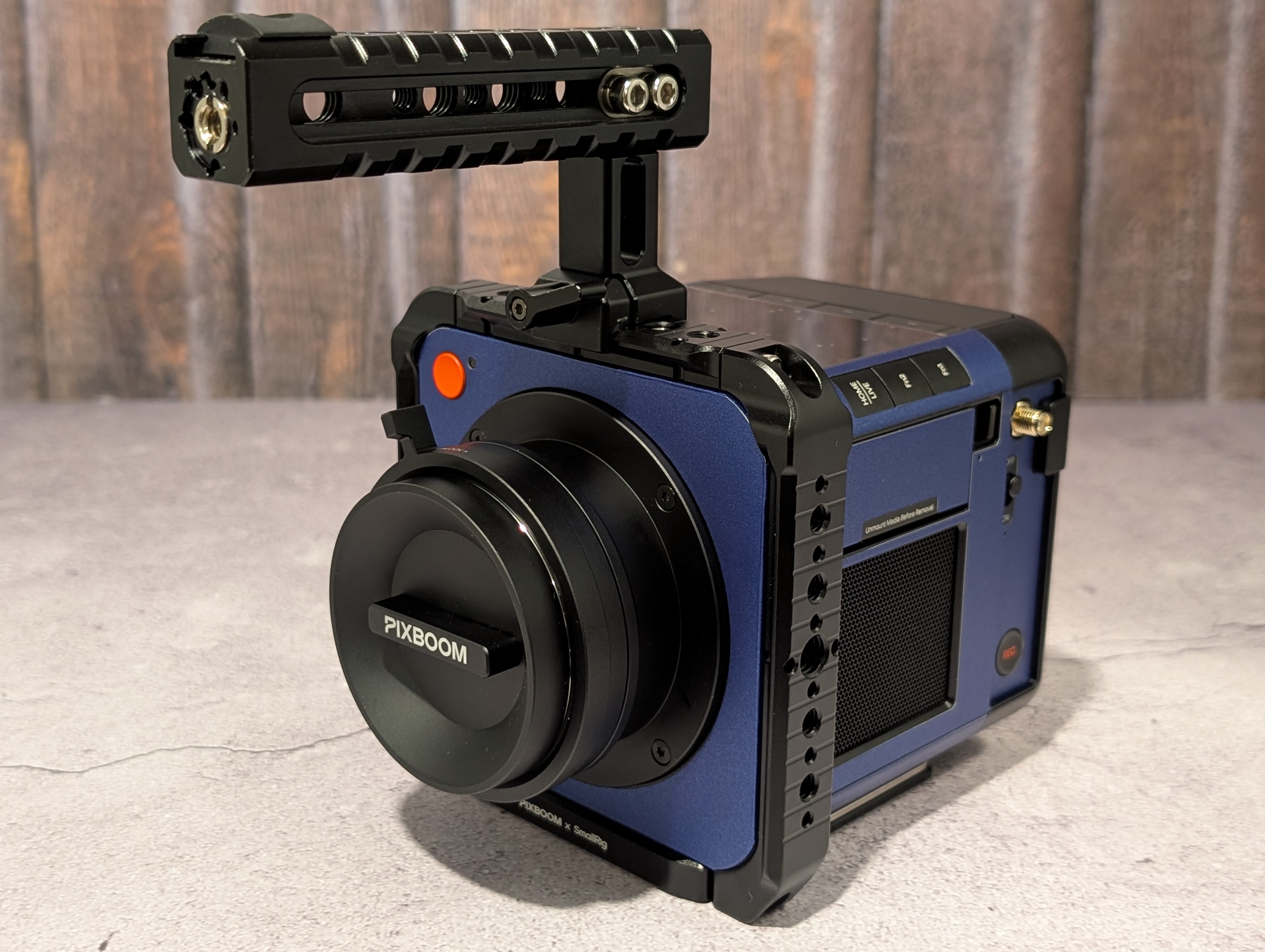

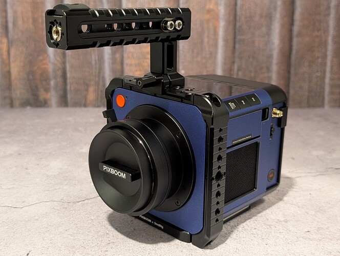

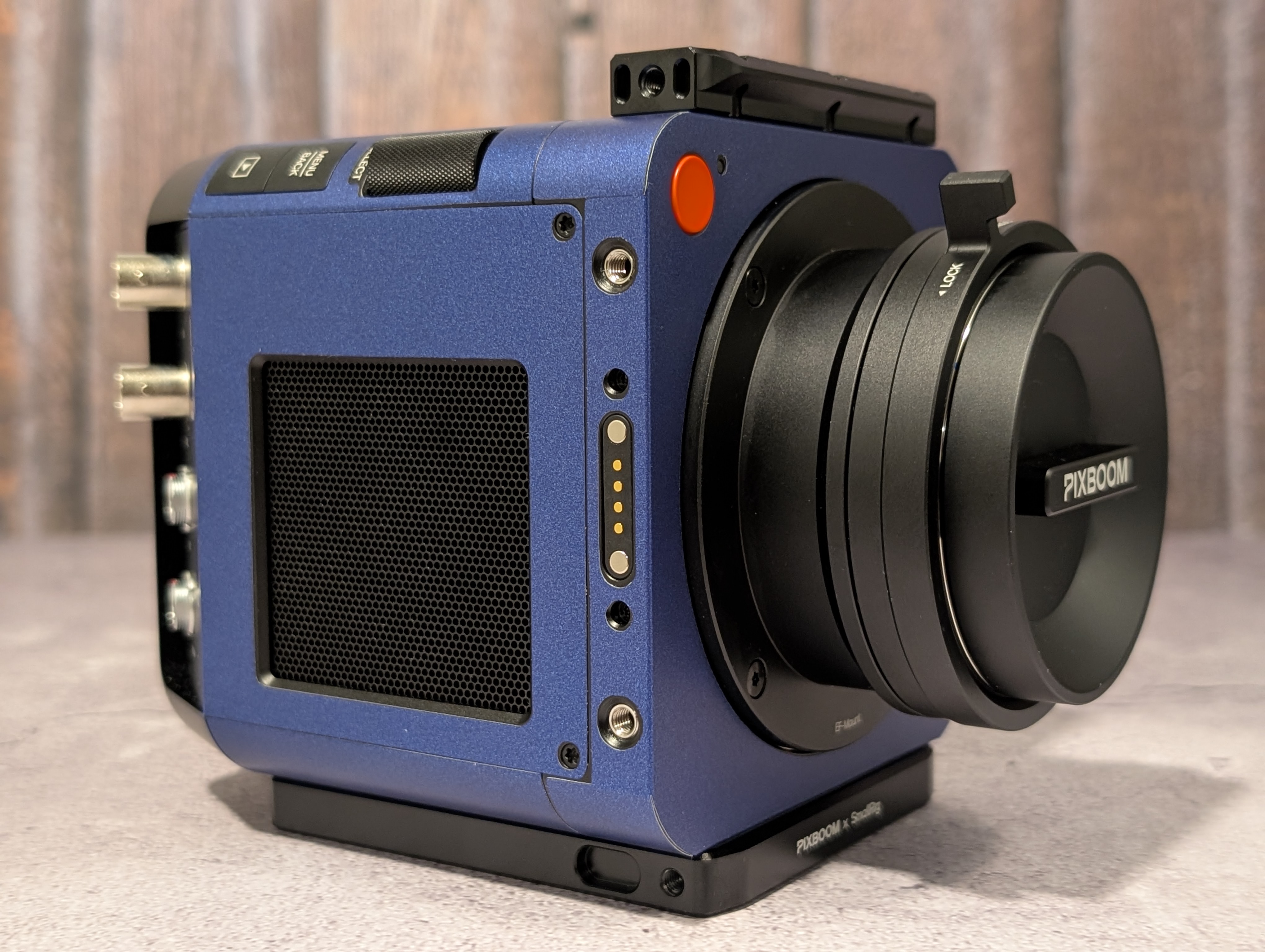

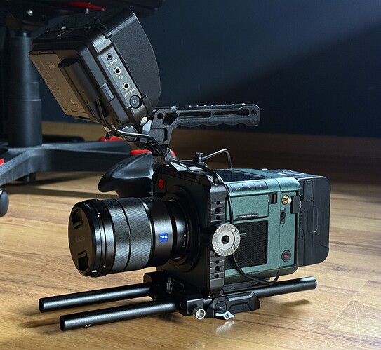

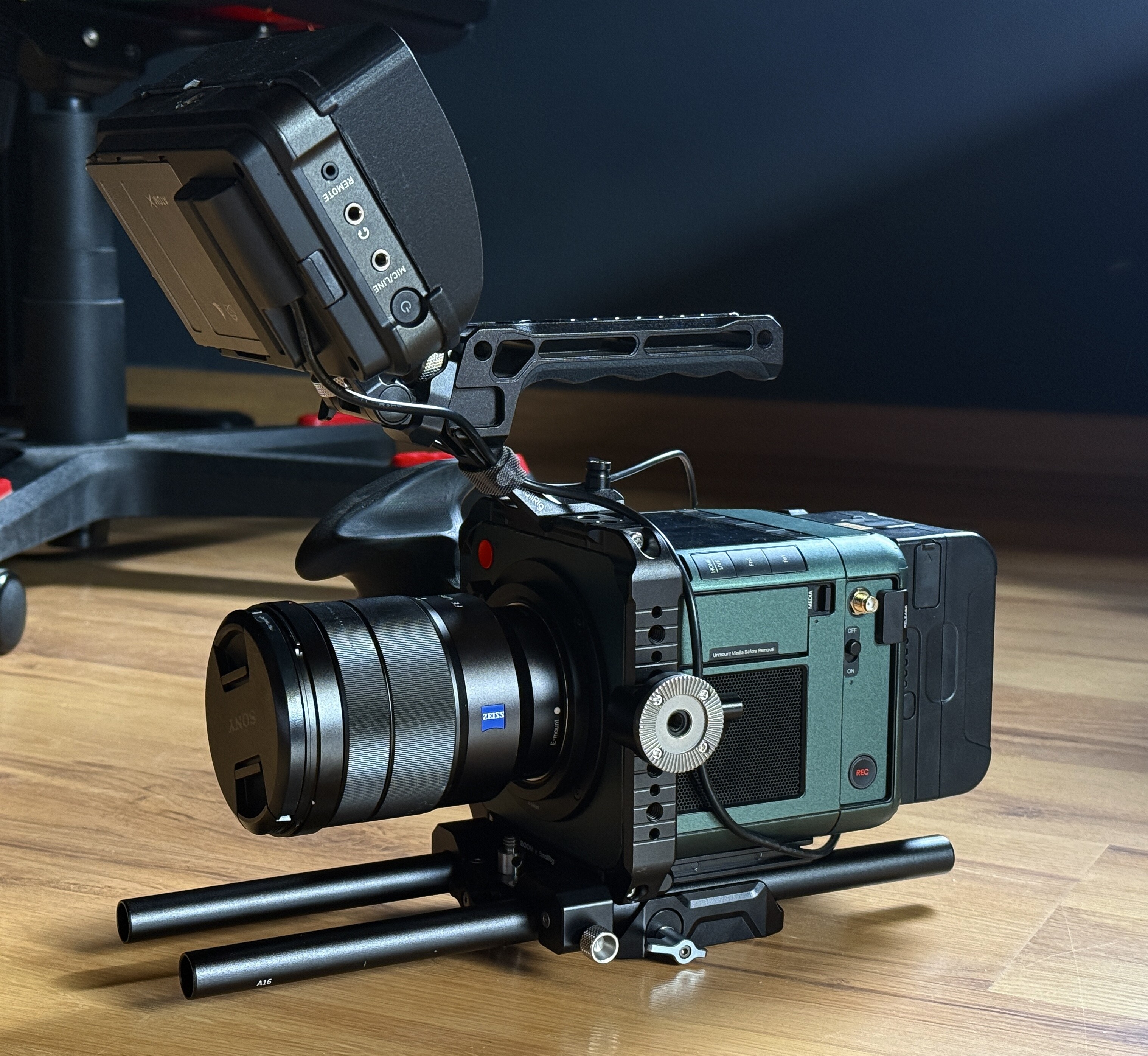

One of the first things I bought for my Komodo was a vinyl wrap skin (though not before a grip put a big scratch in the body while rigging it on its first job). So I wanted to get something on my Spark before taking it out on jobs. I did a lot of drawing, measuring, designing in Photoshop, and thankfully not too much wasted vinyl cutting. It’s not quite perfect (and I haven’t figured out how to tackle the rounded corners on the back), but it’s good enough. Here’s my blue Spark.
I used some automotive vinyl (3M 2080) I had sitting around from other projects. This is the most difficult thing I’ve made a wrap for, as I usually just skin very basic things without a lot of cut outs, seams, or odd shapes. I probably spent 15+ hours on it.
I’ve had my wrap on my Komodo for about 6 years now and it’s held up great, so hopefully this one lasts as well and keeps my camera looking as mint as possible underneath.

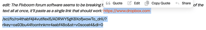

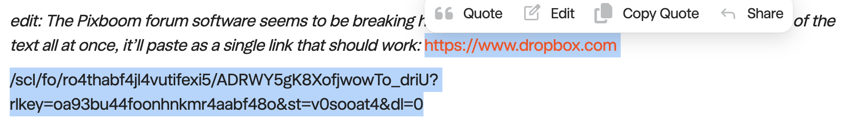

edit: The Pixboom forum software seems to be breaking how the link is shared, so if you copy the two halves of the text all at once, it’ll paste as a single link that should work: https://www.dropbox.com
/scl/fo/ro4thabf4jl4vutifexi5/ADRWY5gK8XofjwowTo_driU?rlkey=oa93bu44foonhnkmr4aabf48o&st=v0sooat4&dl=0
The files will need to be turned into vector graphics in your preferred program. I dropped them into Cricut Design Space (which unfortunately doesn’t let people share projects that use designs created outside their program, so I can’t share my project file). The files have the sizing in the file name, measured in millimeters. So “Spark Front 147 wide” will need to be scaled to 147mm wide, while “Spark door 52_5 wide” would be scaled to 52.5mm wide on your vinyl cutting program.
I may make some refinements down the road (minor sizing changes, like only fractions of a millimeter), but I think this works pretty well. I did mis-space the top two screw head access holes on the “front 147 wide” file on the vinyl I cut for my camera, but I think I fixed the spacing in the uploaded file, though didn’t test cut again since the slightly off version was good enough to not waste another chunk of vinyl recutting it (they’re the screws holding the body together, so don’t really need to be accessible anyway unless it’s getting serviced and get hidden by the SmallRig cage anyway). So if anybody does make it, let me know how those top holes line up.

Hey K.F. Wright, thank you very much for making your files available to us. Unfortunately, the following error message appears: “Error (400) Something went wrong. Your files are of course still safe, and the Dropbox team has been notified.”
Yep, same error for me
After some testing, it looks like the forum software is reformatting the link and breaking it. I changed it by breaking the link up into chunks (so the forum software isn’t auto-generating a link from the whole string) and you should be able to copy the text and paste it into the browser bar and it’ll work. I tested it in an incognito window and it functions for me now.
Haha that’s smart! Worked for me, thank you very much!
First off thanks for making these files available for all of us! Time effort and dedication is appreciated. Got my Spark in earlier today and was super excited to print out a skin.
If you ever figure out how to do the rear portion, keep us posted. You did a phenomenal job on this version, fitment was great.

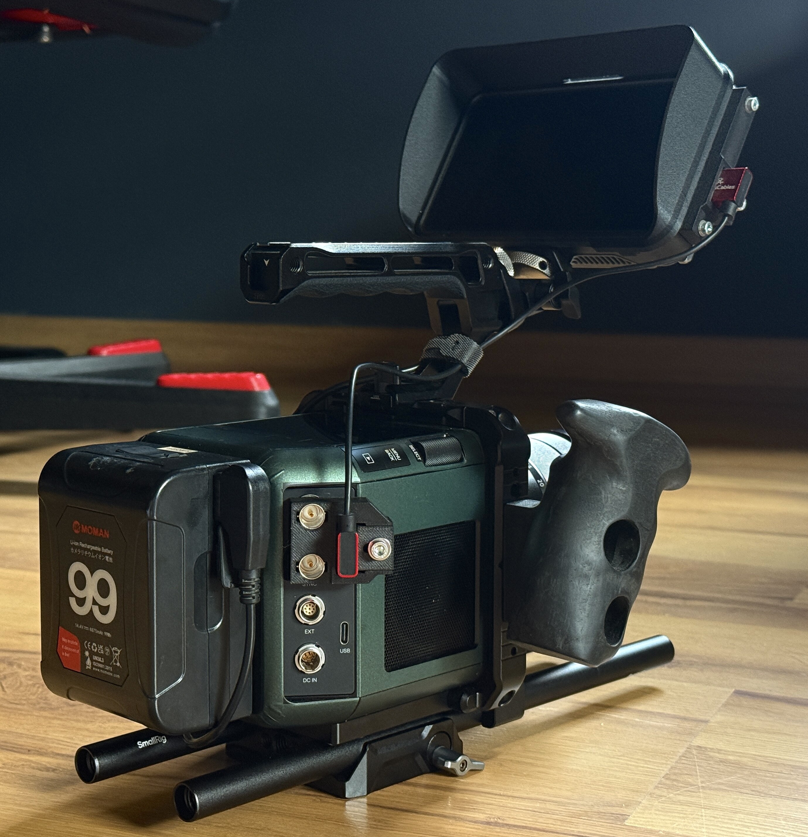

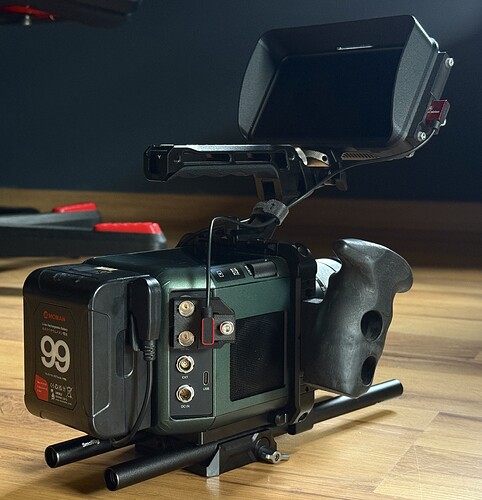

Thanks for putting in the work, I used 3M 2080 Pine Green Metallic. Love it!
Nice job! Now you definitely have a one off unit of the Spark :slight_smile:
That looks great! Awesome color choice.
