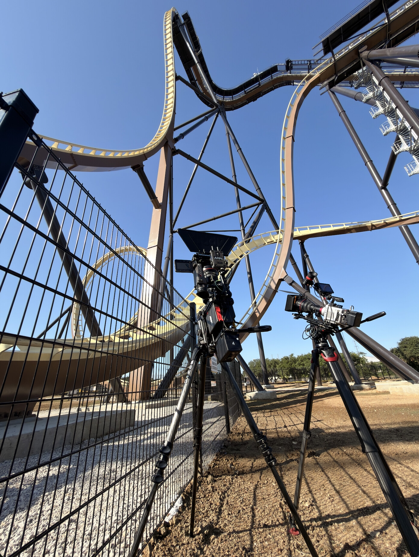

I thought I’d share a little write-up from this week’s shoot at Six Flags Over Texas, where we were filming Tormenta, the world’s tallest dive coaster.

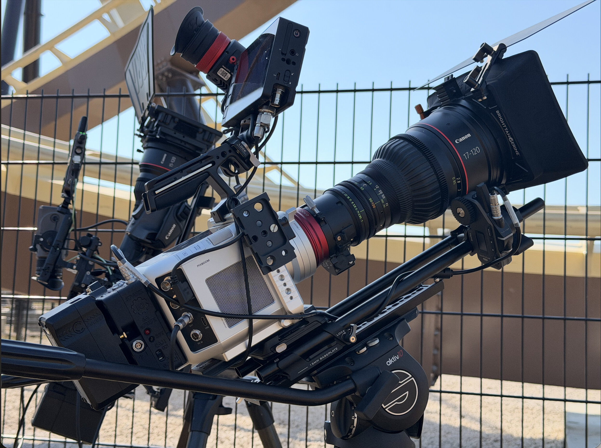

My Spark, now officially named Quick Silver, performed flawlessly in the blazing Texas summer. The outside temperature was around 100°F, with a real feel of 113°F, and there wasn’t much shade to be found. The camera stayed powered on and shooting from roughly 8:00 a.m. until 4:00 p.m., with only brief interruptions for battery changes and normal production pauses.
I switched the fan from Low to Medium as a precaution, but the internal temperature remained remarkably stable all day, hovering between 50°C and 53°C.
Zero failures. Zero missed captures.
Once again, the camera simply did its job—and did it well.
I was shooting alongside an ARRI Alexa Mini, and interestingly, the Mini actually became much hotter sitting in direct sunlight. That may have been partly due to its dark carbon finish versus my shiny silver Spark body. (One of the many reasons I chose the silver version.)
The Mutiny Power I/O also worked flawlessly, converting my V-Mount setup to Gold Mount while providing run/stop control through the 3-pin port for my Tilta motors. I started the day using Core SWX Nano 98Wh batteries before switching to IndiPRO 250Wh Gold Mounts, simply to reduce battery swaps throughout the day.
Swapping between the EF and PL mounts is incredibly simple and only requires a T8 Torx driver. I brought along a Wiha Micro Bit set, which had everything needed.
One thing I’d still like to see from Pixboom is guidance on default shim configurations for each mount type. I couldn’t find any mention of this in the manual. It wasn’t an issue for me since the Canon CN7 has built-in back-focus adjustment, but it would be helpful to know the factory shim stack and recommended starting point for each mount.
For example, DZOFilm provides a chart for the Vespid lenses that specifies how much shim adjustment is typically required when changing from EF to PL. Having a similar reference from Pixboom would help establish a good baseline before fine-tuning flange depth.
Our schedule was compressed this time, so we weren’t able to mount the Spark directly on the coaster as originally planned, but I was still happy to put it to work on the ground.
