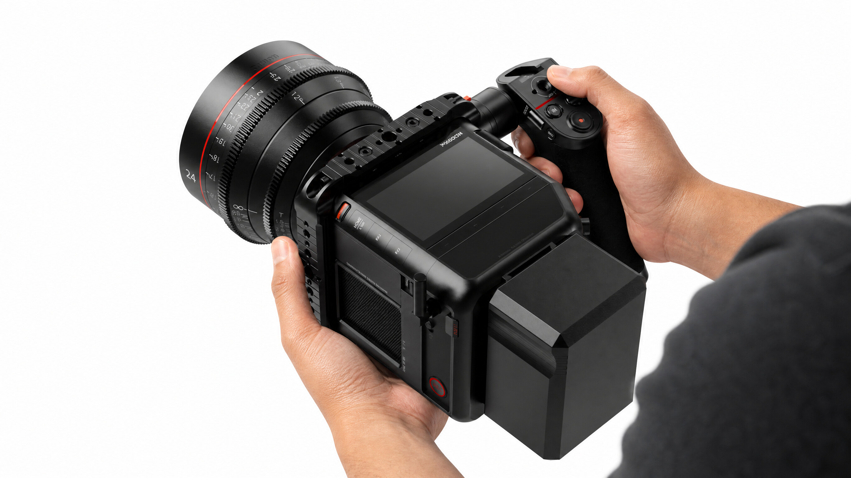

What the design looks like today
Three ways to hold it, one handle.

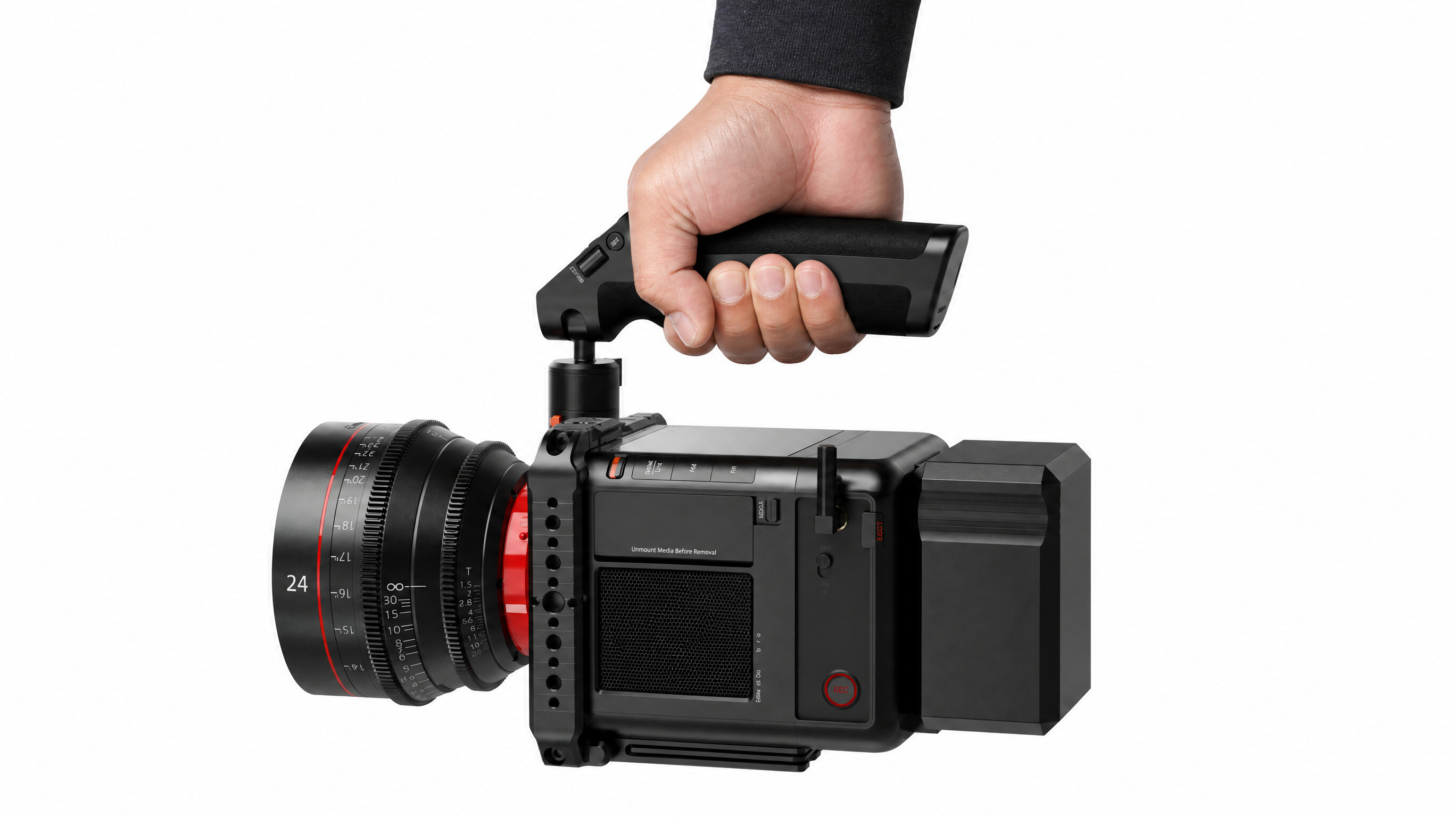

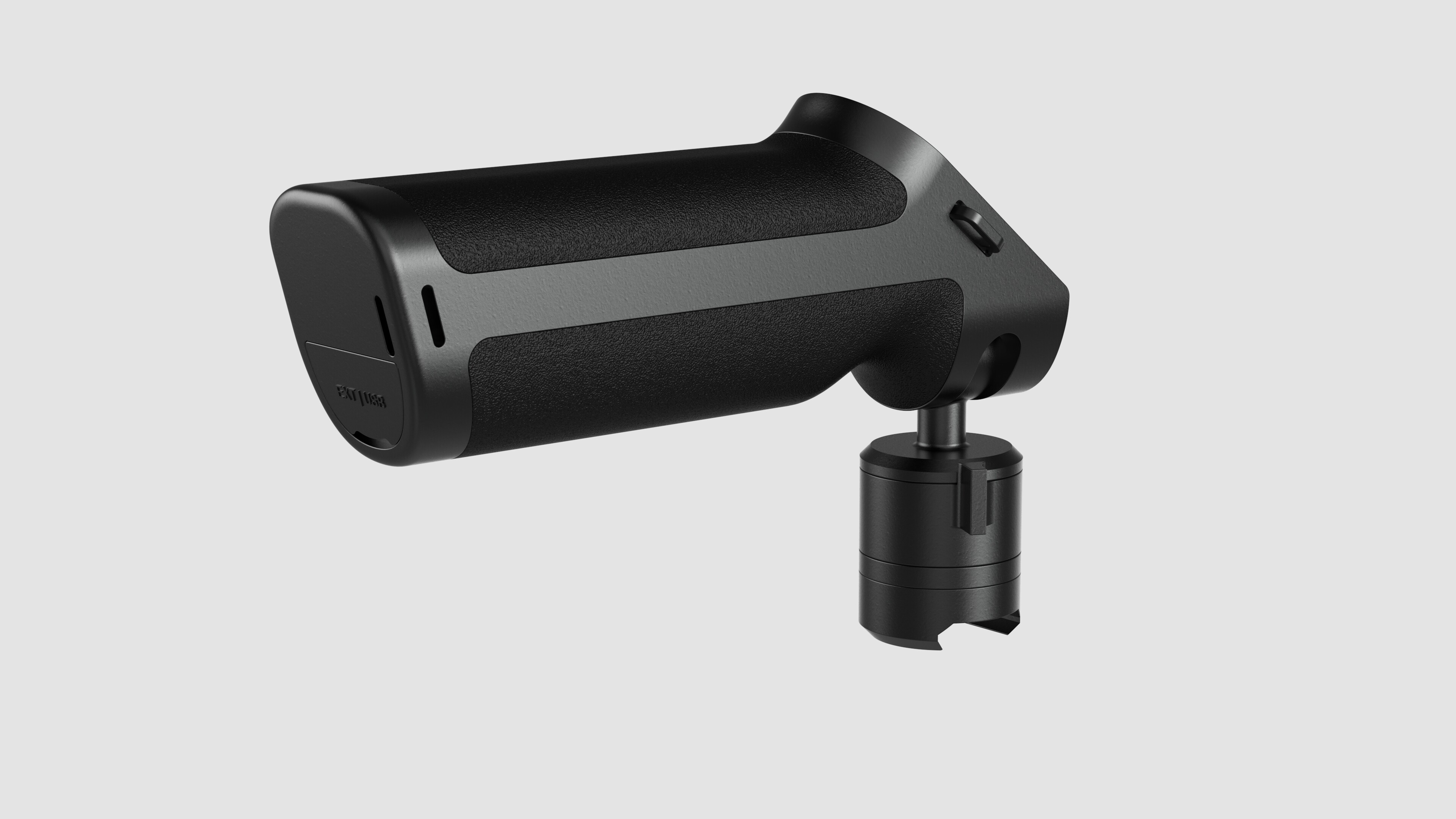

Top grip, side grip, and off-camera remote — wireless or wired. Switching between top and side mounting is a quick-release move, no tools.
Most of the camera in your hand.

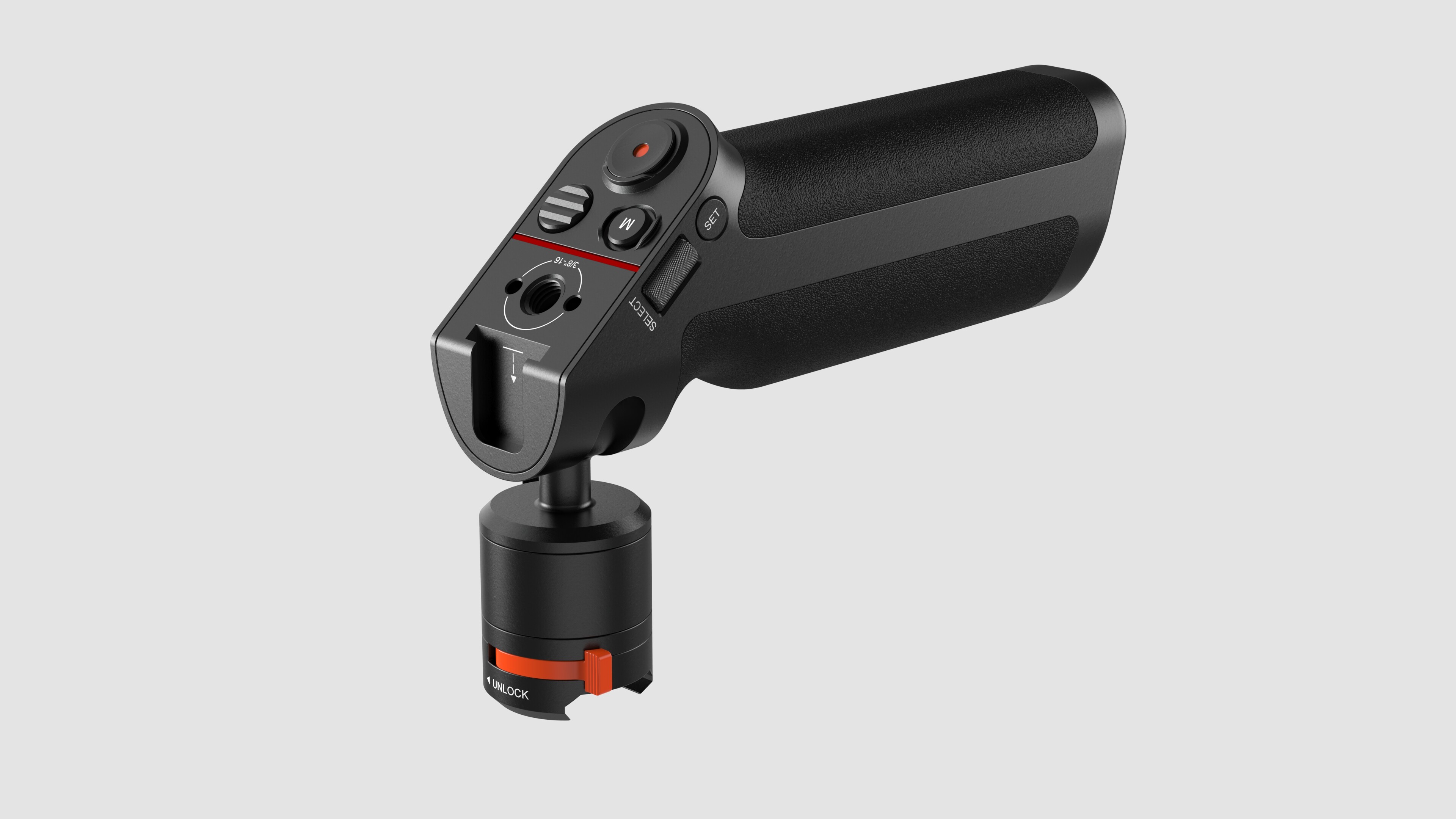

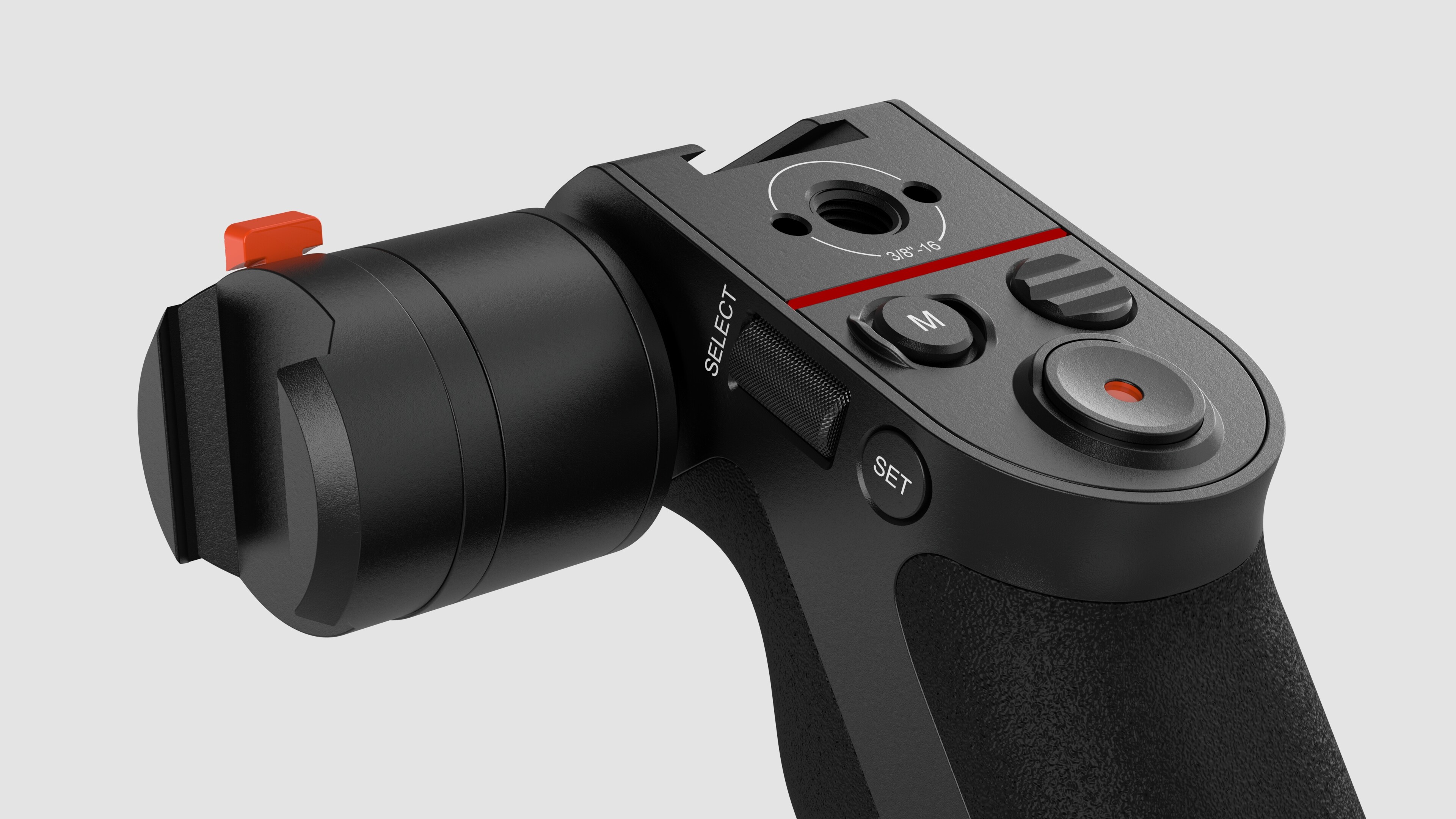

Record start/stop, shooting parameter adjustment, switching between record and playback, clip selection with fast forward/rewind in playback, OSD toggling, and so on.
You always know if it’s rolling.
A light bar on the handle switches between green and red, so recording status is visible at a glance, from the side, from behind, or from across the room.
Built for long days outside.
The grip geometry, rubber overmould and control placement were worked out for extended handheld use, and the enclosure is designed to an IP rating suited to outdoor work.
Industry-standard mounting, plug and play.
NATO rail, 3/8"-16 with locating pins, and a cold shoe on top, so your existing monitor, mic and cage hardware go straight on.

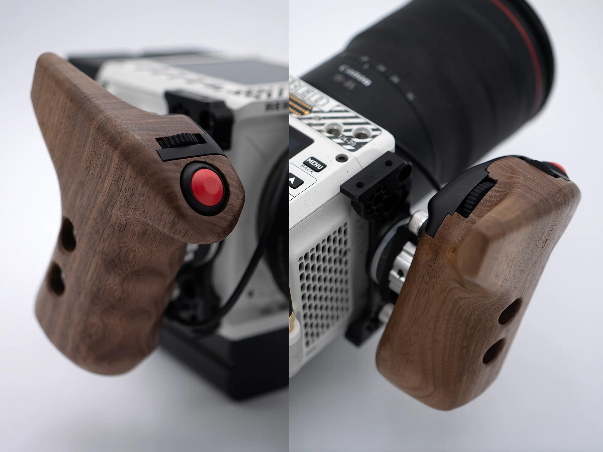

This is the RVLVR LABS Clutch Camera Remote Handle, which I used and absolutely loved on my beloved RED Komodo. It is an ARRI-rosette side handle that feels incredibly comfortable, ergonomic, and practical.
My ideal version of Pixboom Spark would feature: 2 fully customizable, clickable control wheels + 1 dedicated REC button

My preference is for side handles rather than top on smaller cameras; the top handle gets in the way more often than not, especially when the monitor is on top.
