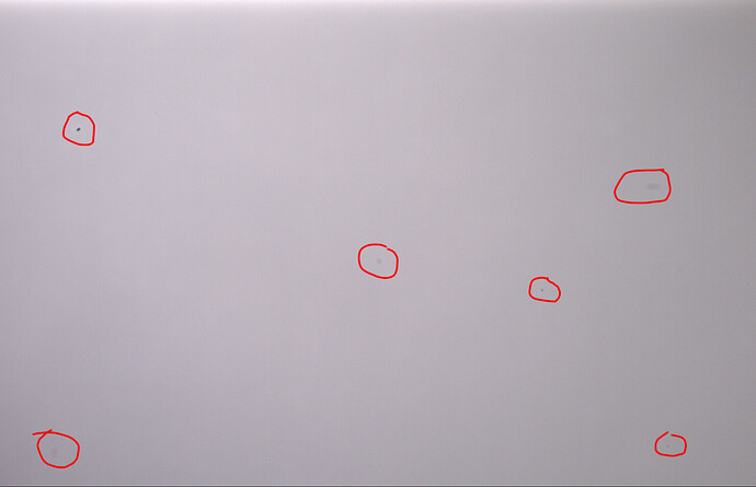

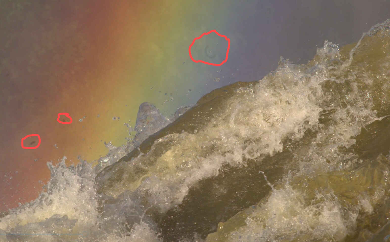

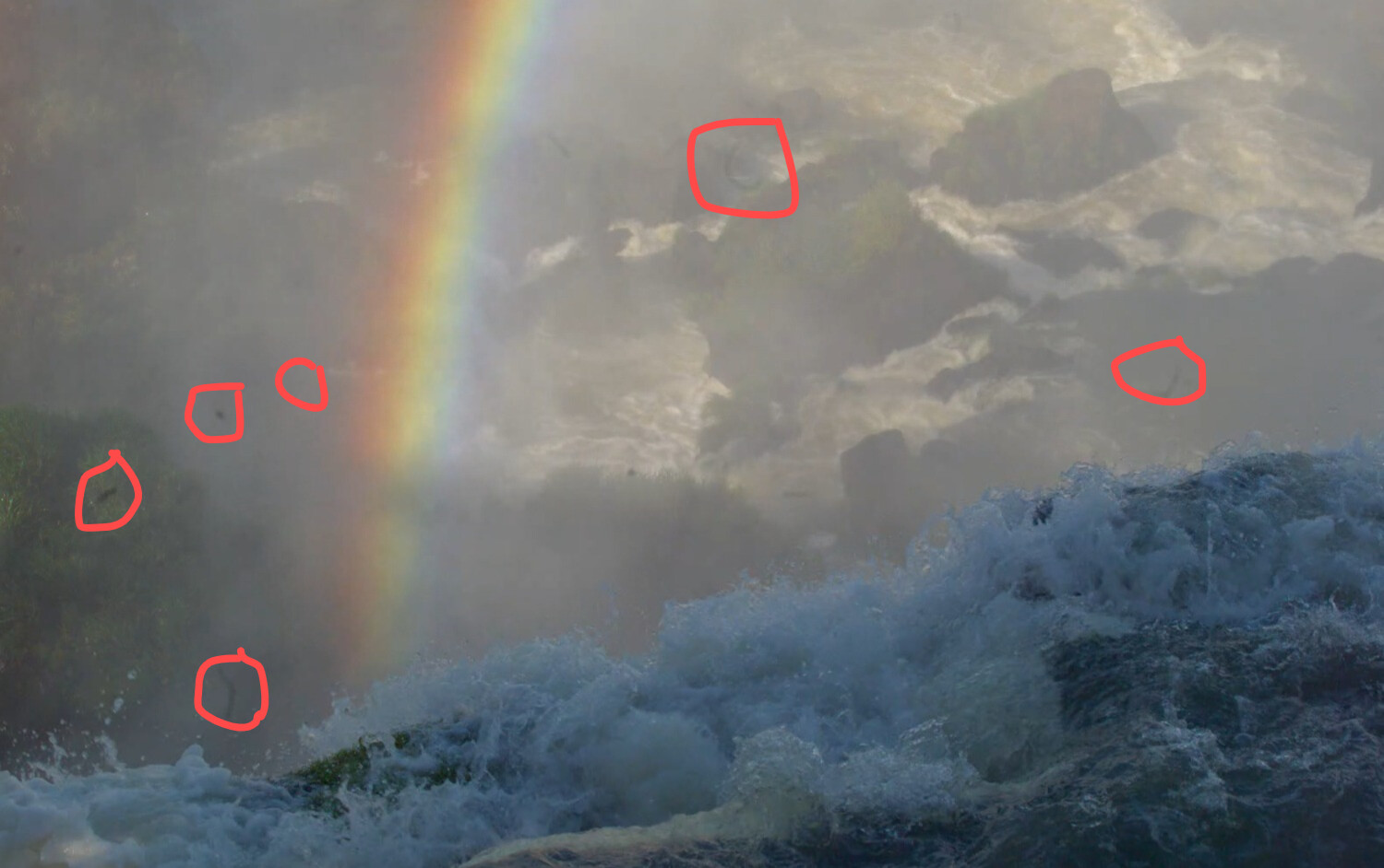

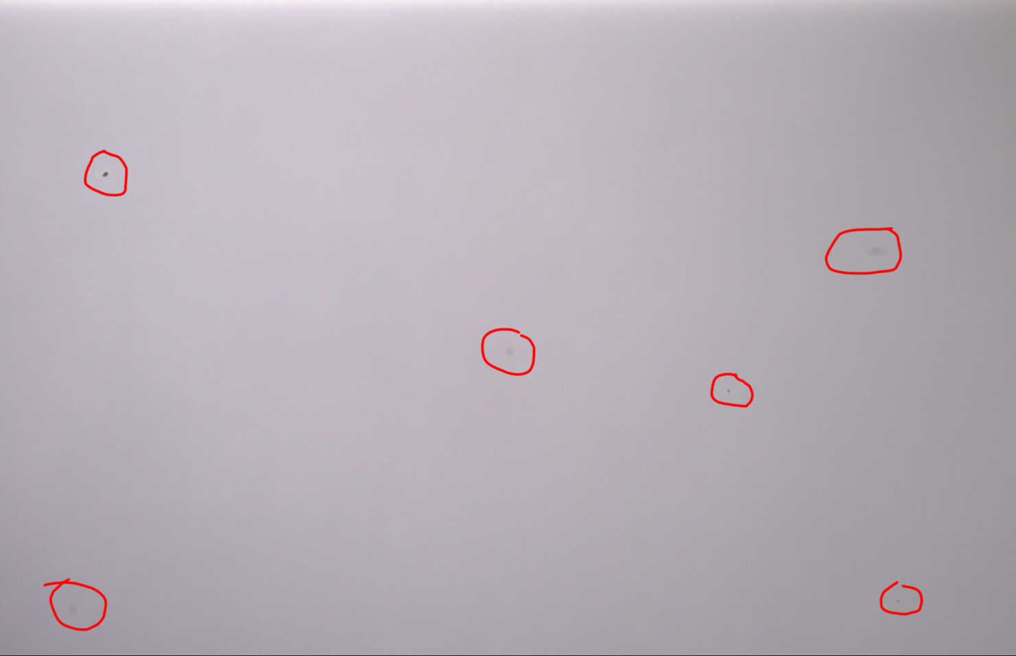

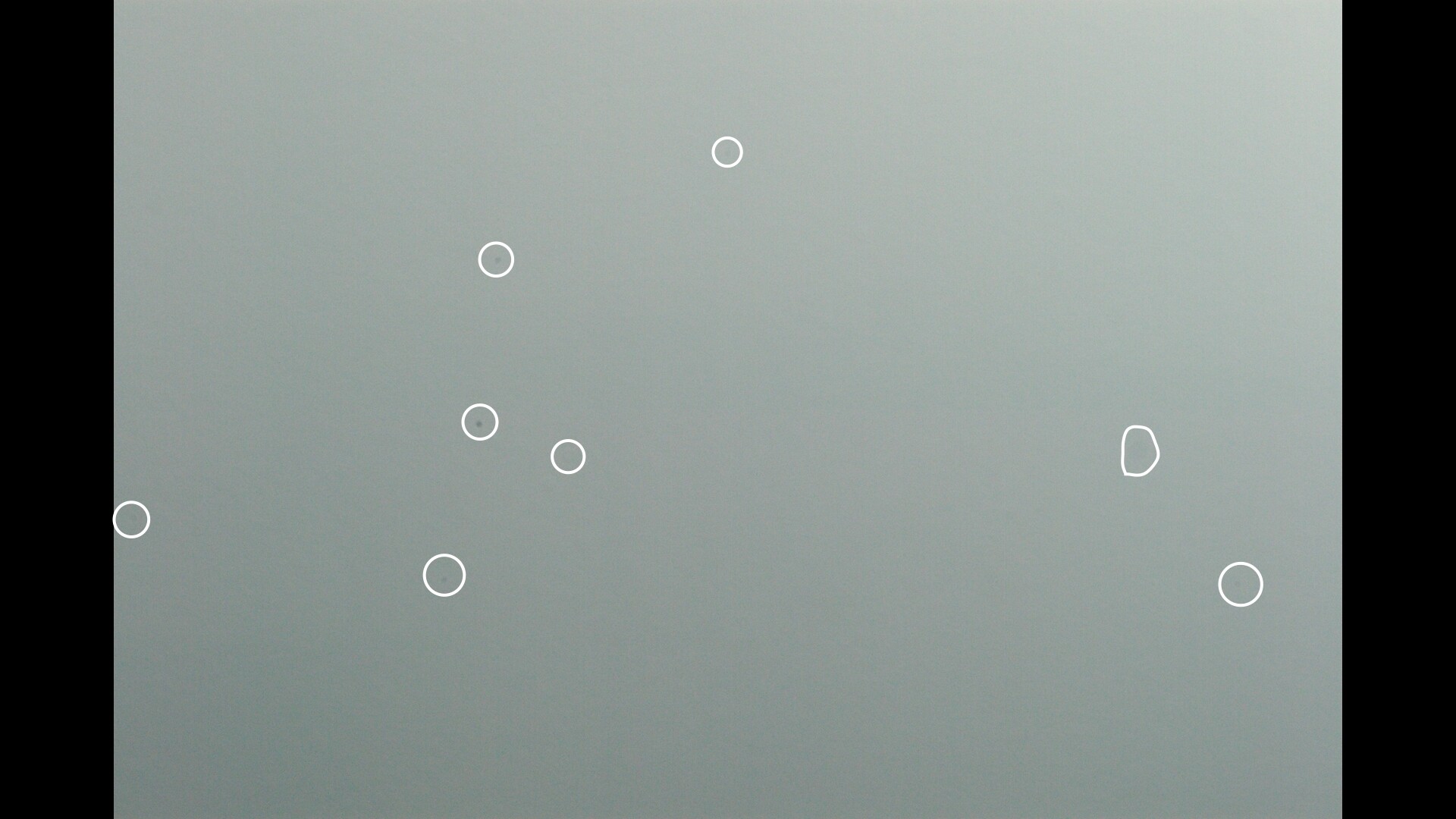

Hey- my spark came in yesterday and I’ve been running some tests/getting to know the camera but there appears to be dirt under the glass cover on the sensor?  It was like this right when I unboxed it and I can’t seem to get rid of it.
  • Appears with all lenses and isn’t effected by focus changes
-didn’t come off when cleaning the sensor
-isn’t visible when looking at the sensor
-does not appear to be dead pixels as the edges aren’t clean and they take up multiple neighbouring pixels
Would love to know if anybody else is having this issue?
Same with mine… :-(     try to clean, but nothing to see…It seems to be sitting somewhere else…not on the glass…
Any solution?
Is wet cleaning of the sensor recommended? It doesn’t seem to be dust…

i have the same issue…

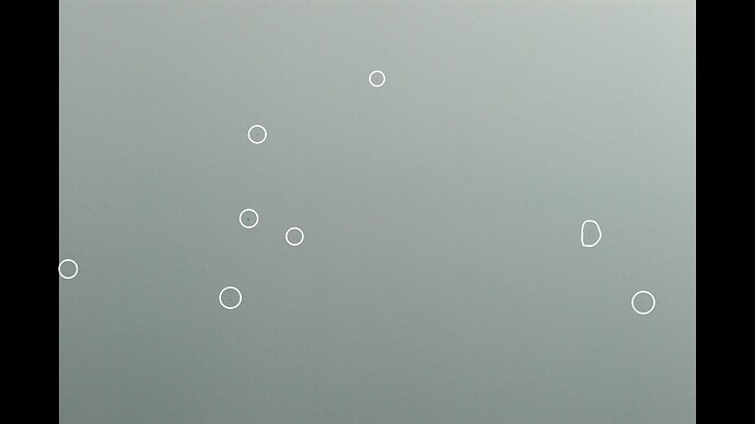

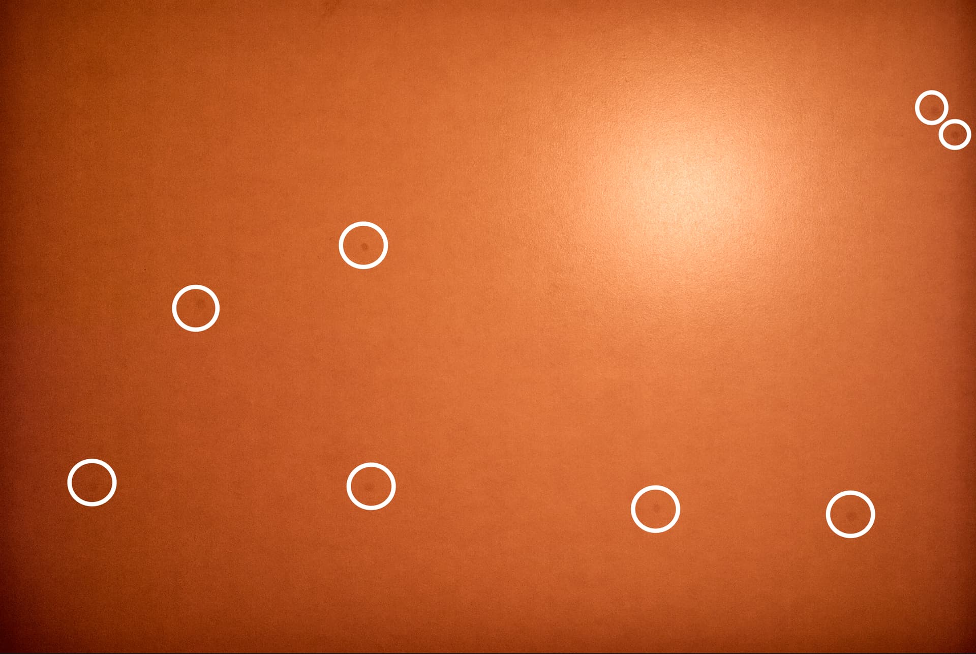

I am Backer #258. Unfortunately, as I feared, I am experiencing the same issue.
After thorough testing with different lenses, the camera sensor shows several spots in post-production that will not go away, even after using a certified cleaning kit. Naturally, these spots become most visible when pushing the contrast to extremes during editing.
Could you let me know what steps you are taking to resolve this issue? Has Pixboom responded to you yet?
Photo:Uploading: sensor.png…
Hey they contact me today
I had to take close up picture of the sensor
And to take two shots one with Lens on a uniform background and one without the Lens
