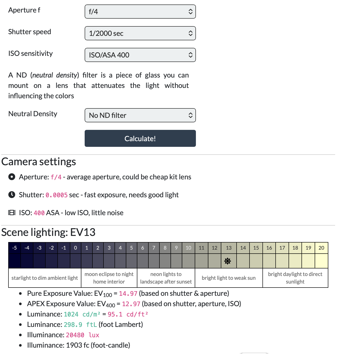

I have a shoot tomorrow in studio and can share a few tips after then however just by doing the math now its pretty easy to calculate how many Foot Candles you need.
This was based on a UHD 4K 937 FPS capture using 180 shutter.. So around 1/1874 / sec exposure time, exposing for T4 at 400 Iso
You will need 1903FC … … Now you just need to understand where the light will be and measure the distance between the fixture and subject + add any losses from diffusion.
Minimum spec you could use a 1200x putting out 1840fc from 3M or 9.8ft away ( this would be with a 45 degree reflector ( Hard Light ) per apurtures spec sheet.
To achieve lighting a 12x with 1/2 grid would need alot of light… Like I showed above, you just need the distance of light placement to give an accurate number… Inverse Square Law …  Each time you double the distance you retain only 25% of the light output.
When shooting through or boucing something I like too make two calculations… One from the fixture to the output of the shoot thru or bounce… and then from the NEW soft light source to your subject. Because each time you modify the light it because a new light source.
Photography light calculator · toolstud.io?
Thank you for this and the light calculator! I’ll put in some research with this.
