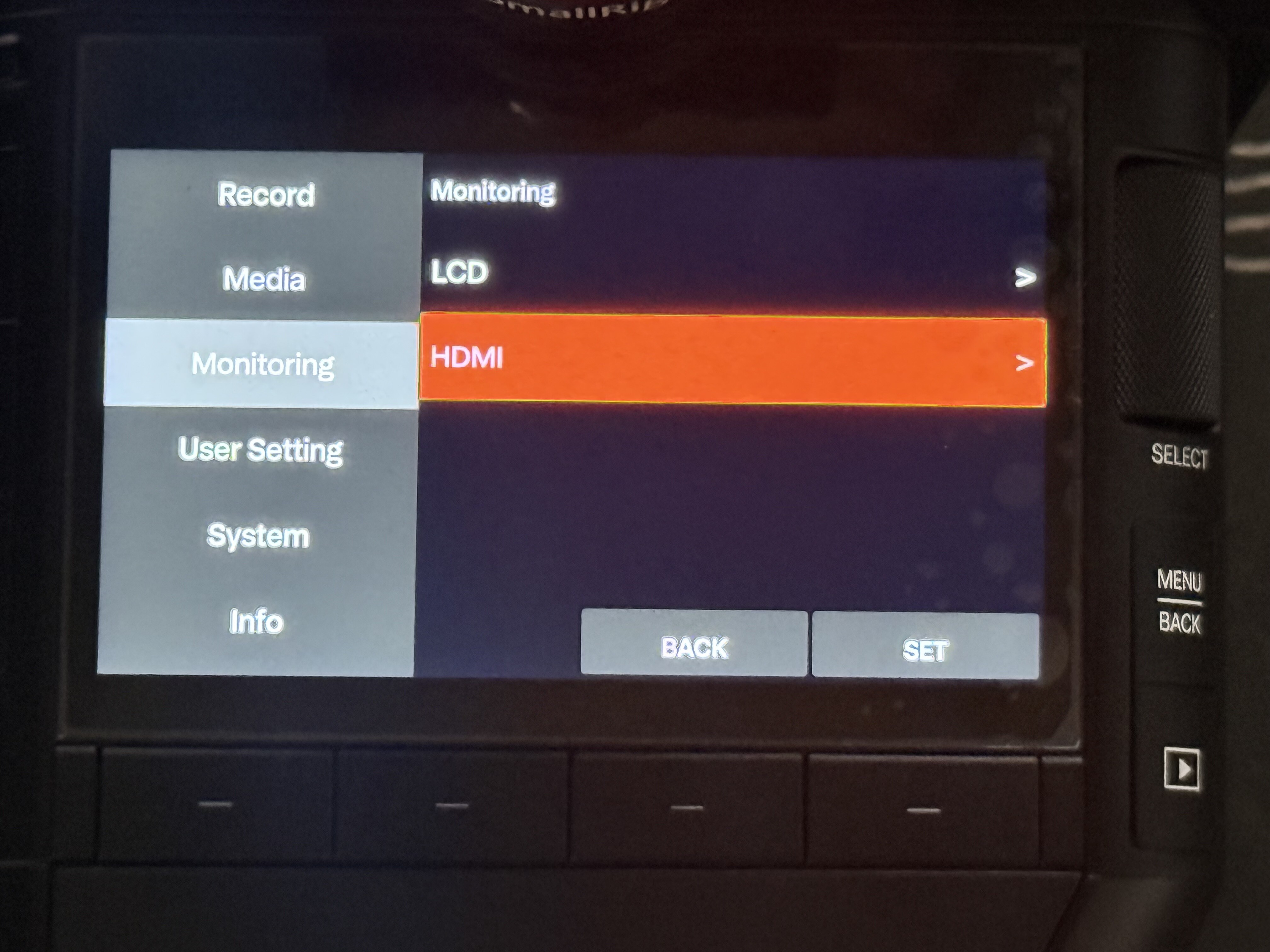

I have updated the firmware to 20260604_101325 but I still cant get SDI to show up as an option for monitoring. Any ideas?
According to the firmware update notes, 4K HDMI was added. It doesn’t mention SDI being enabled, so that isn’t a feature that’s been activated yet.

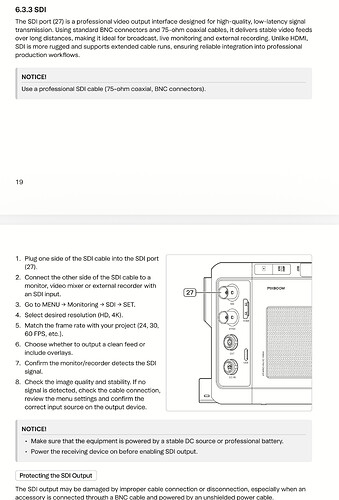

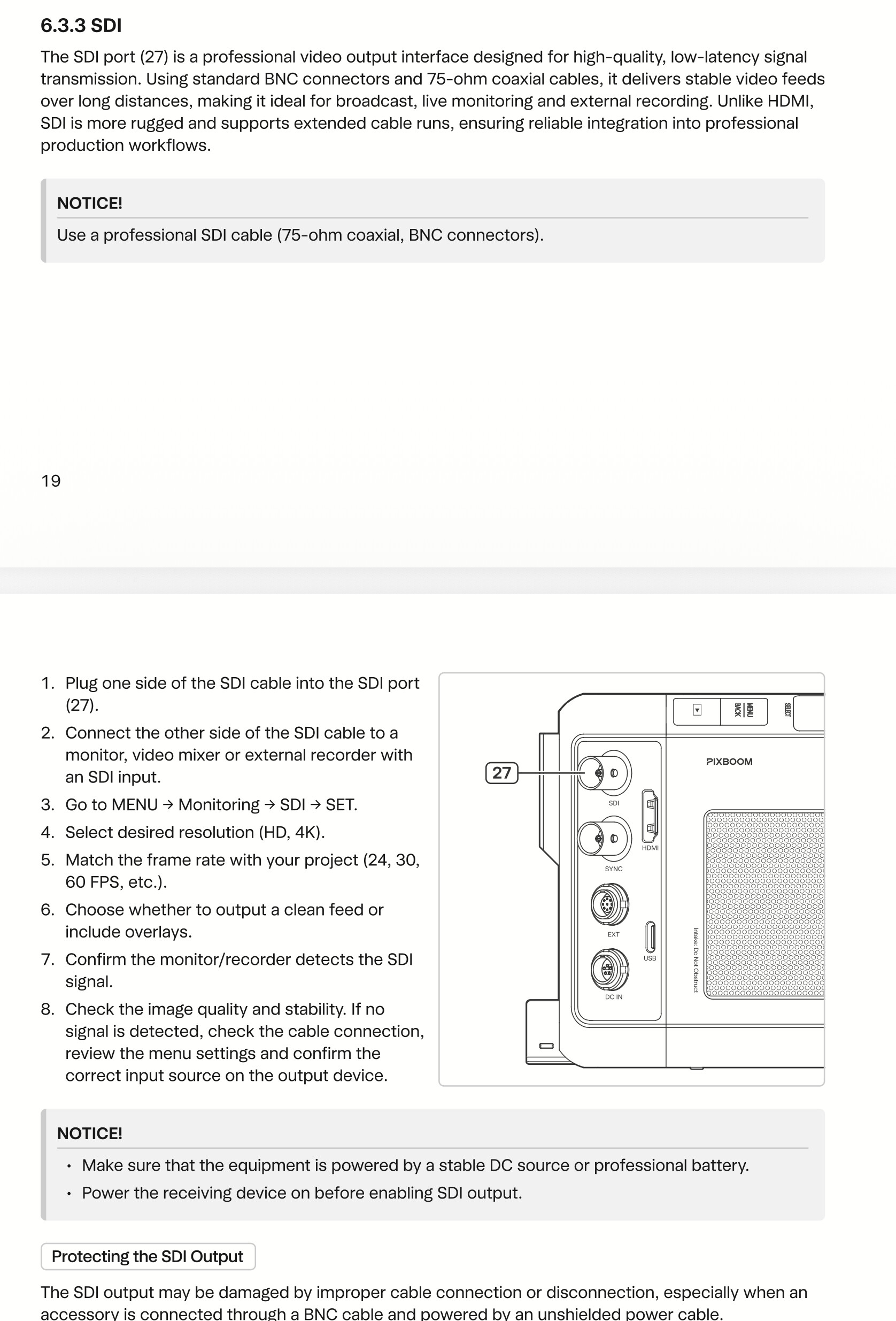

SDI isn’t really a “feature” unlock. it’s a basic standard port on the camera. the manual says it should be working. Does your camera show an SDI option?
They’re apparently still working on SDI.
Yeah, in one of the other threads they said SDI is a top priority to get working. I’m guessing the manual was created with the assumption SDI would be enabled, or enabled shortly after. There are a few other functions mentioned in the manual that don’t exist in camera yet.

SDI is not enabled yet. Earliest we will see it is July.
