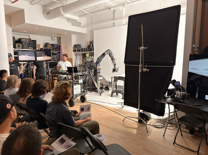

Last night, Ryan from Revar Cine and Tokina hosted a Spark workshop in New York City, bringing together some of the industry’s top DPs, ACs, and content creators interested in the latest developments in high-speed cinema.
A special thank you to Nick Debas for leading the workshop, shooting, and showing us the potential of the Spark in action. We also have to thank Rainbow Studios for providing both the location and the Bolt cinema robot.
Revar Cine invited me to participate as another voice for the Spark and to bring my own Spark body for attendees to see and use. It was a great opportunity to meet and share what I have learned to other filmmakers interested in incorporating the Spark into upcoming projects.
What stood out most to me was that many attendees already understood the advantages the Spark offers over similar cameras on the market, such as its BSI sensor and Global shutter. Everyone was eager to get their hands on one for their own productions.

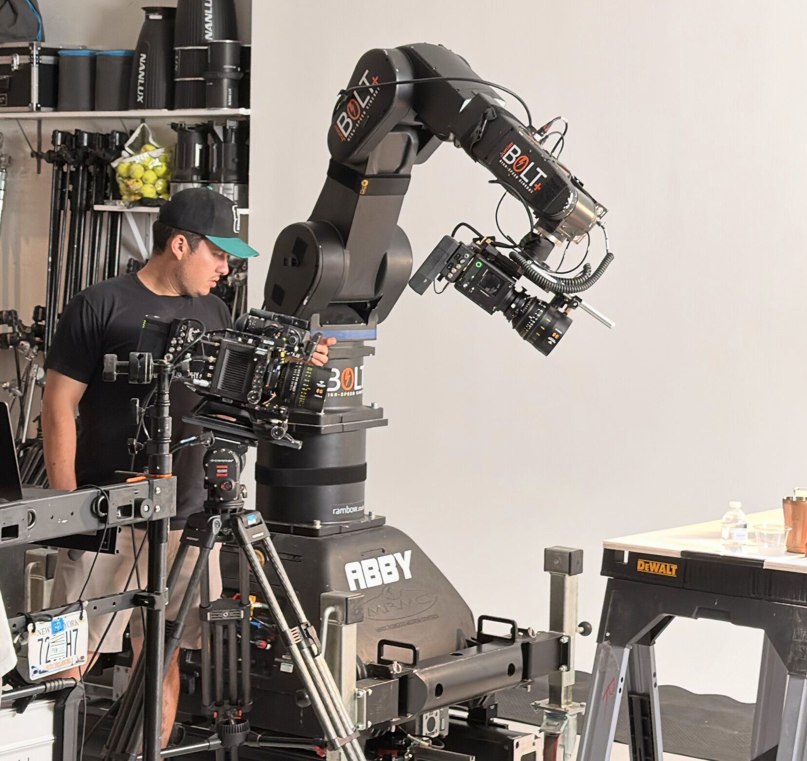

The demonstration Nick set up featured a bartender pouring ice and a liquid into a glass. An ARRI camera was set up on a tripod at 200 fps as a comparison shot; the Spark was mounted on the Bolt robot and filming at UHD 4K 937 FPS, setting us up for a dynamic arc movement around the glass. While looking at both cameras on the monitor, they showed some color differences between the Arri and Spark sensors… However…
After the shot, Nick pulled footage from both cameras and performed a live color match between the ARRI and the Spark. While the workflow will continue to be refined, I was impressed that he was able to achieve roughly a 90% match in just 2-3 minutes on his laptop using Davinci.
Overall, it was exciting to see such strong interest in the Spark and its potential for immediate use in productions.
Different DP’s of various backgrounds all got to have a look at my camera and do a little test shooting of their own. The most common feedback I heard throughout the evening was how easy the camera is to use, and its build/form factor is perfect for rigging out.
