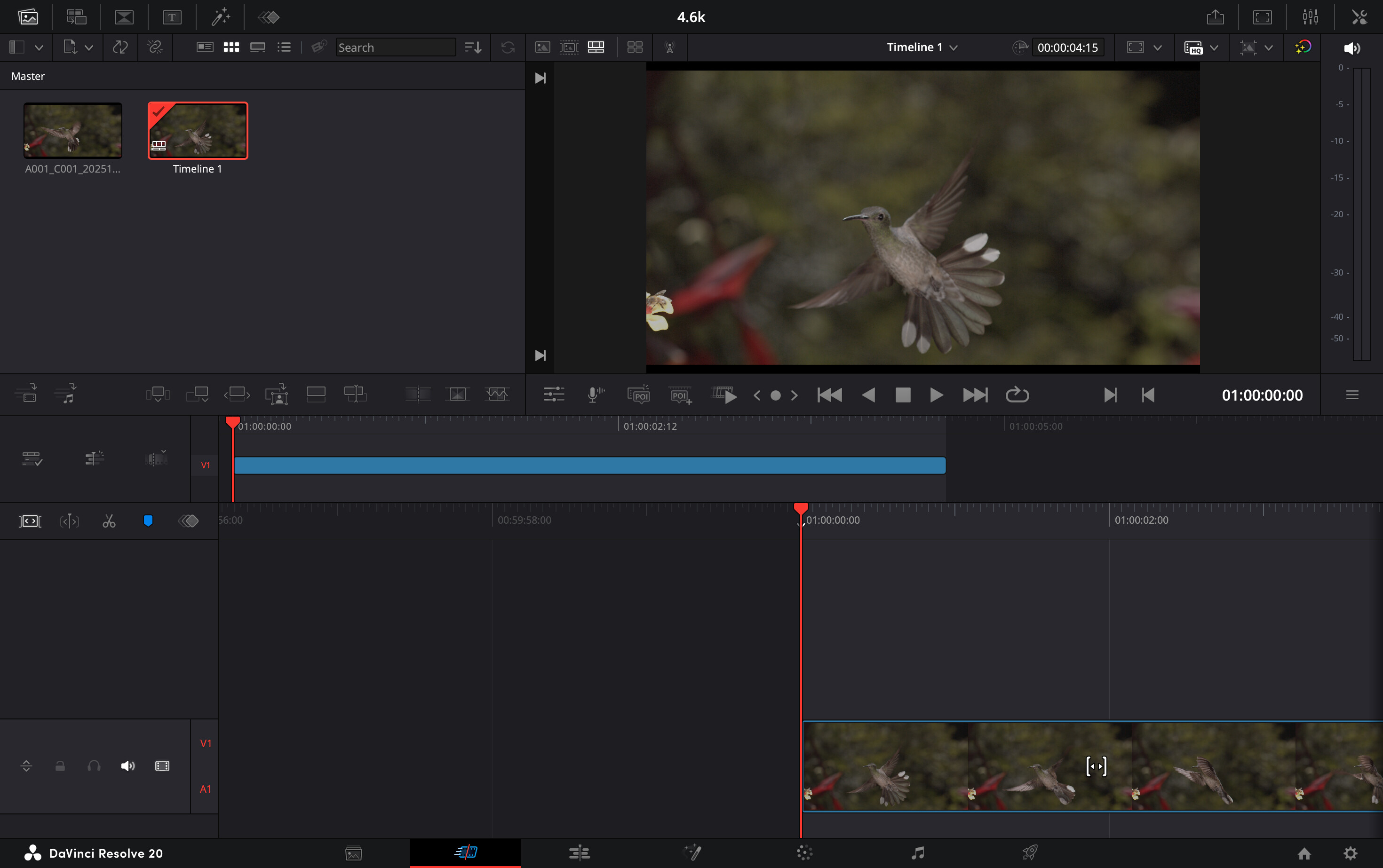

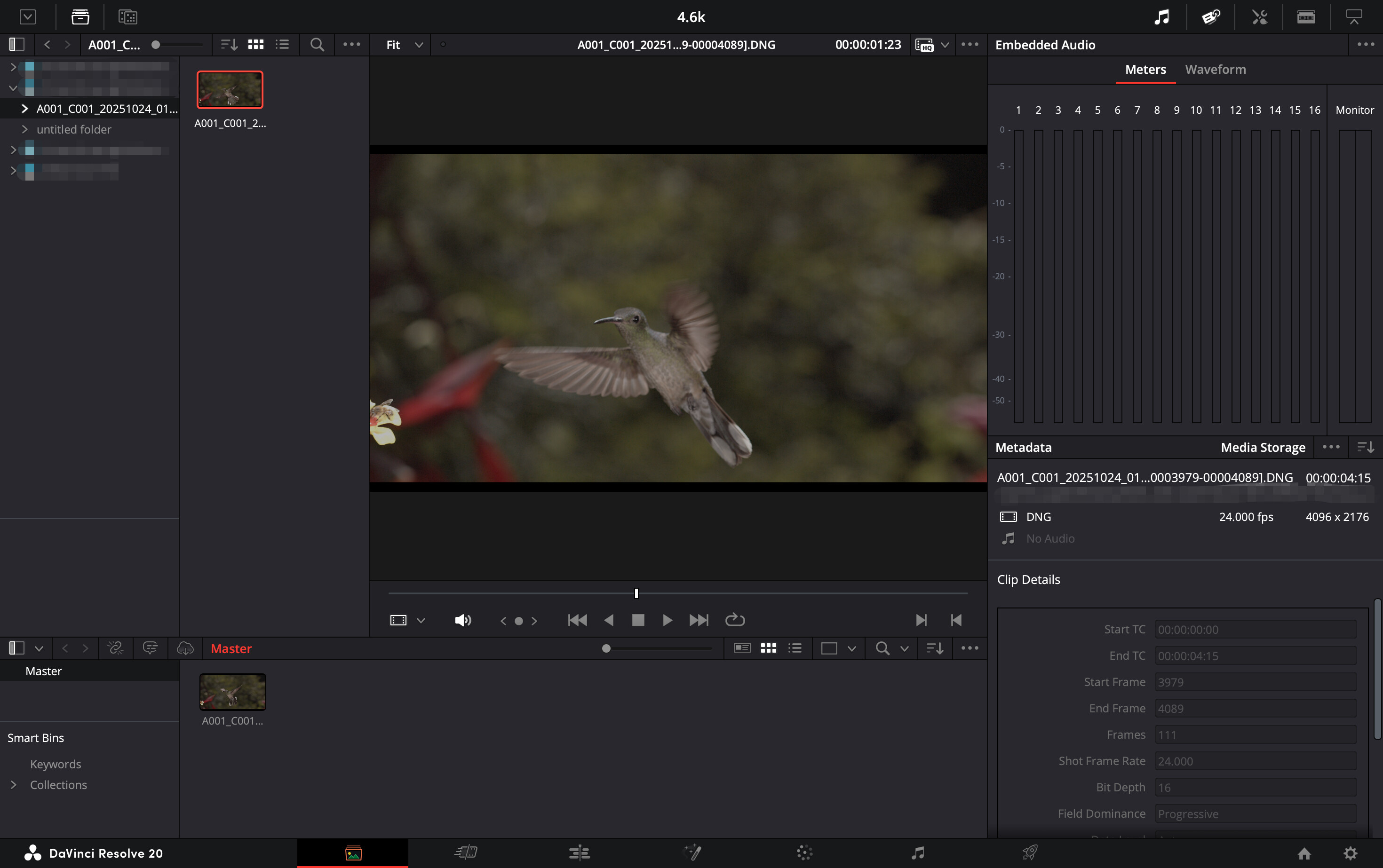

After shooting, import the CinemaDNG sequence into DaVinci Resolve. Navigate to the directory containing the original CinemaDNG files, the consecutively numbered CinemaDNG image sequence will be automatically recognized and displayed as a single clip, which can then be dragged into the project.
User can then add the CinemaDNG clip to an existing timeline or create a new timeline directly from the clip.

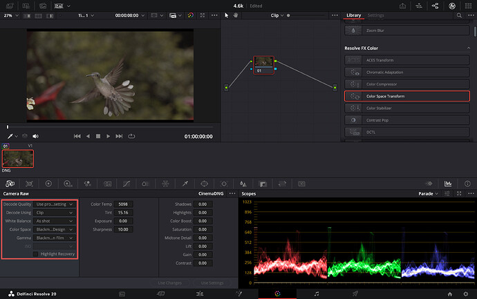

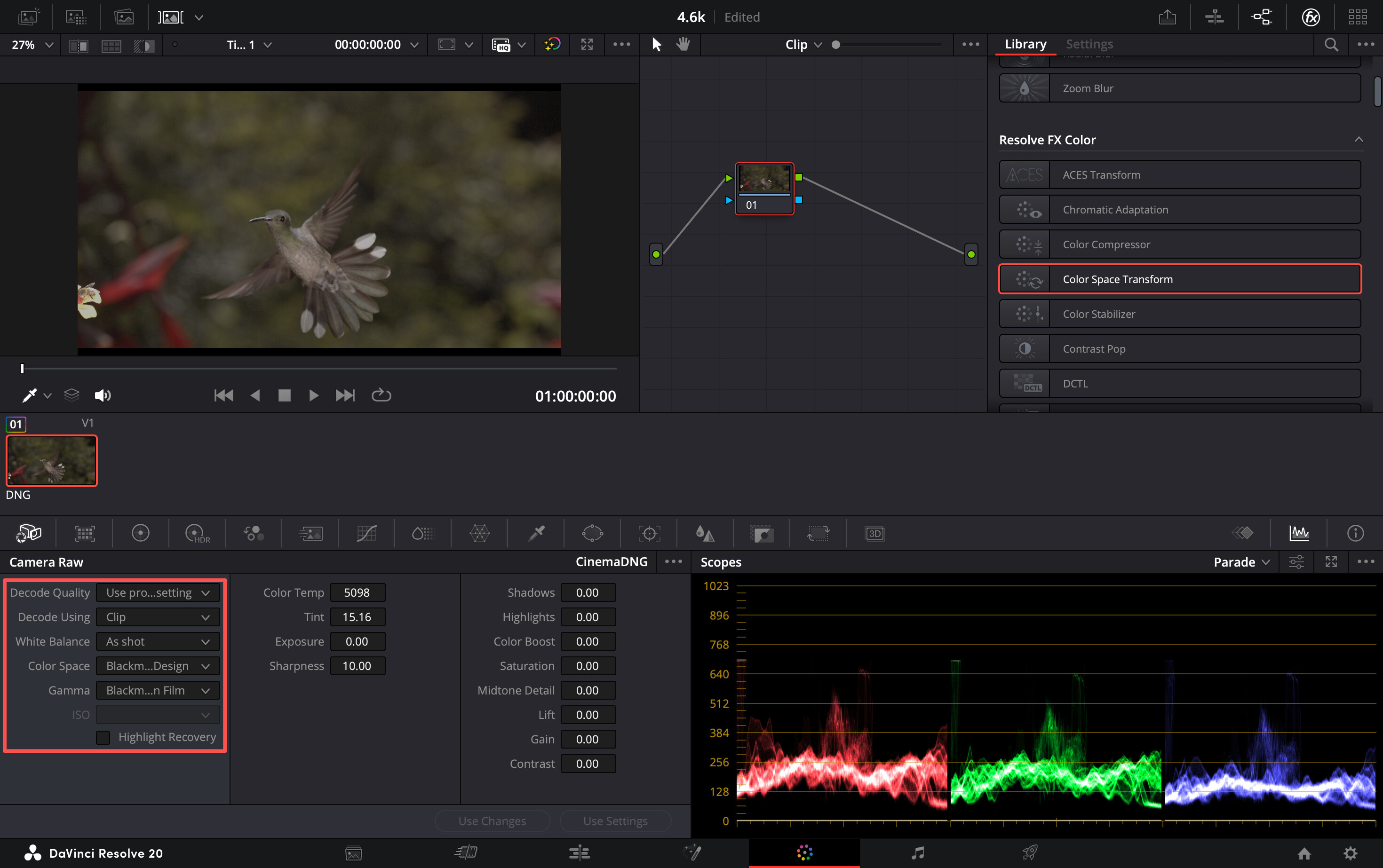

In the Color page, open the Camera RAW tab. Set “Decode Using” to “Clip” to allow the parameters to be adjusted individually for the selected clip. Then, set “Color Space” to “Blackmagic Design” and “Gamma to Blackmagic Design Film”, respectively, as the decoding color space and gamma for the CinemaDNG files. According to Davinci Resolve manual, Blackmagic Design’s logarithmically encoded Blackmagic Design Film gamma setting, which produces flat-contrast, wide-gamut image data that preserves image detail with awide latitude for adjustment, is a modified version of the standard Cineon curve.
“Highlight Recovery” is a checkbox that attempts to recover highlight details when one or more color channels are clipped while others remain below clipping. The additional highlight information is reconstructed by analyzing the unclipped channels, which may help recover detail in partially clipped highlights. However, this process can introduce color shifts or other image artifacts. Test and use this option according to the specific footage and desired result.
On the right, several RAW processing options are available, allowing parameters such as white balance and exposure to be adjusted non-destructively.

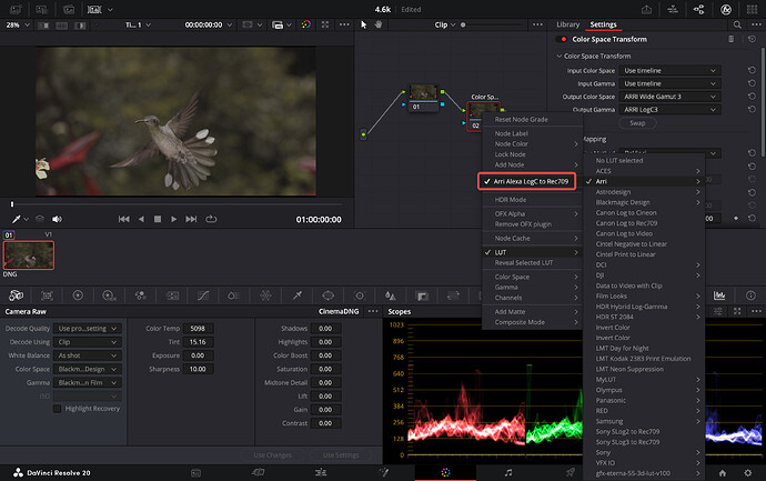

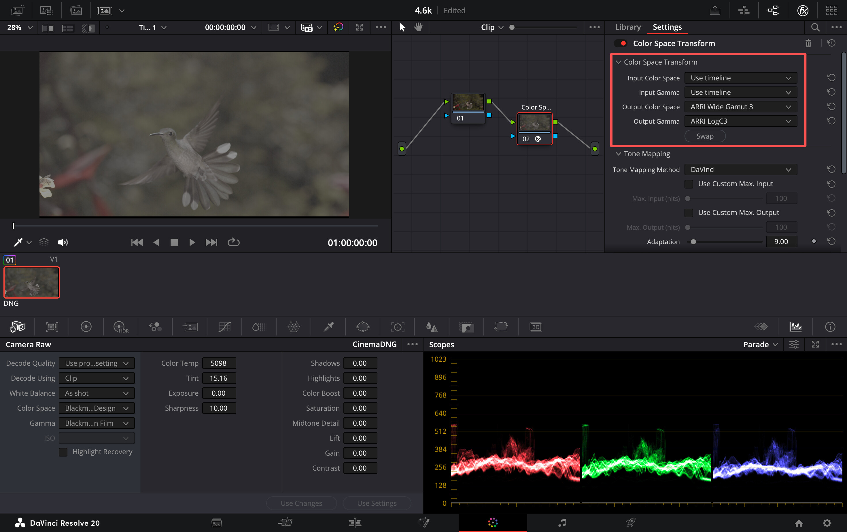

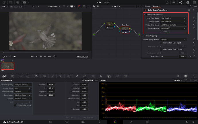

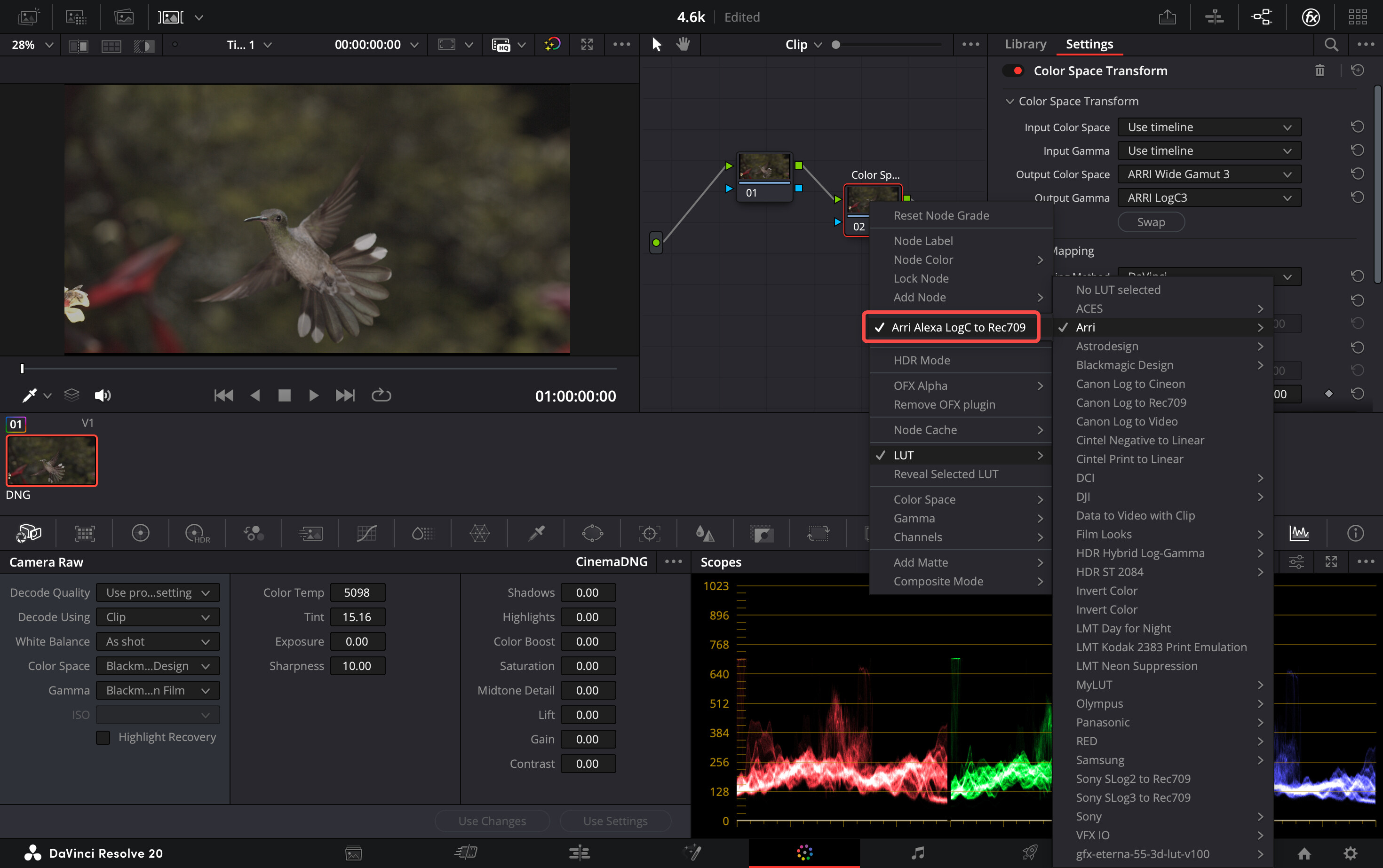

Next, add a Color Space Transform (CST) node to convert the footage from the color space configured above to Rec.709 or another desired color space. Alternatively, the footage can be converted to the color space of another camera to facilitate color matching between different camera sources. In this example, ARRI Wide Gamut 3 and LogC3 are used as the target color space and gamma. Other options can be kept as default or adjusted in case of need. Users can then perform further color adjustments and grading within this color space.
Finally, apply a LogC-to-709 LUT in this node to convert the footage to the Rec.709 color space for delivery and distribution. Alternatively, users can select and apply the appropriate output transform for their desired delivery color space.

  1. What’s your Color Management set to?  Color Managed or the classic YRGB. Whats the Timeline Color Space?
  2. If you are working in a 709 color space and apply a CST that is going from 709 to LOG but you are already working with LOG footage (as set to BMD Film in your Raw settings) then you’re essentially ending up with a LOG image that has a further Rec-709 to LOG transform applied to it and will be an insanely flat and unusable starting point for a grade or even LogC to Rec709 adjustment LUT.

For starters, you haven’t specified what your color management settings are. The timeline color space should not be Rec709, it should be something like either ACEScc/cct or DaVinci Wide Gamut  + Intermediate.
You should not be mapping your Pixboom footage to Rec709, you should be mapping it to the timeline color space for color grading.
The display color space is where you should be choosing a display color space, such as Rec 709/gamma 2.4 or, if you’re grading for HDR, you might be using a DCI-P3 output.
Using one of the color grading spaces as the timeline space does make matching between cameras easier, and it also makes grading easier since the color spaces intended for timeline internal use are enormous, so they’re harder to clip.

Thanks to you both for the thoughtful feedback. We put this guide together as a starting point, not the only way to grade Spark footage. We used a Rec.709 timeline here just to keep the example simple, but you should definitely use whatever working space best fits your project.
Just one important clarification on the pipeline: Spark shoots linear RAW, so there’s no Log curve baked in. When you select BMD Film in Resolve’s Camera RAW tab, you’re simply debayering that RAW data into BMD Film gamma to kick off your grade. From there, the CST in our guide is meant to take that BMD Film image into LogC—definitely not to slap a Rec.709-to-LogC transform onto BMD Film footage. We’ll update the guide to make the CST settings (especially the “Use Timeline” option) much clearer.
