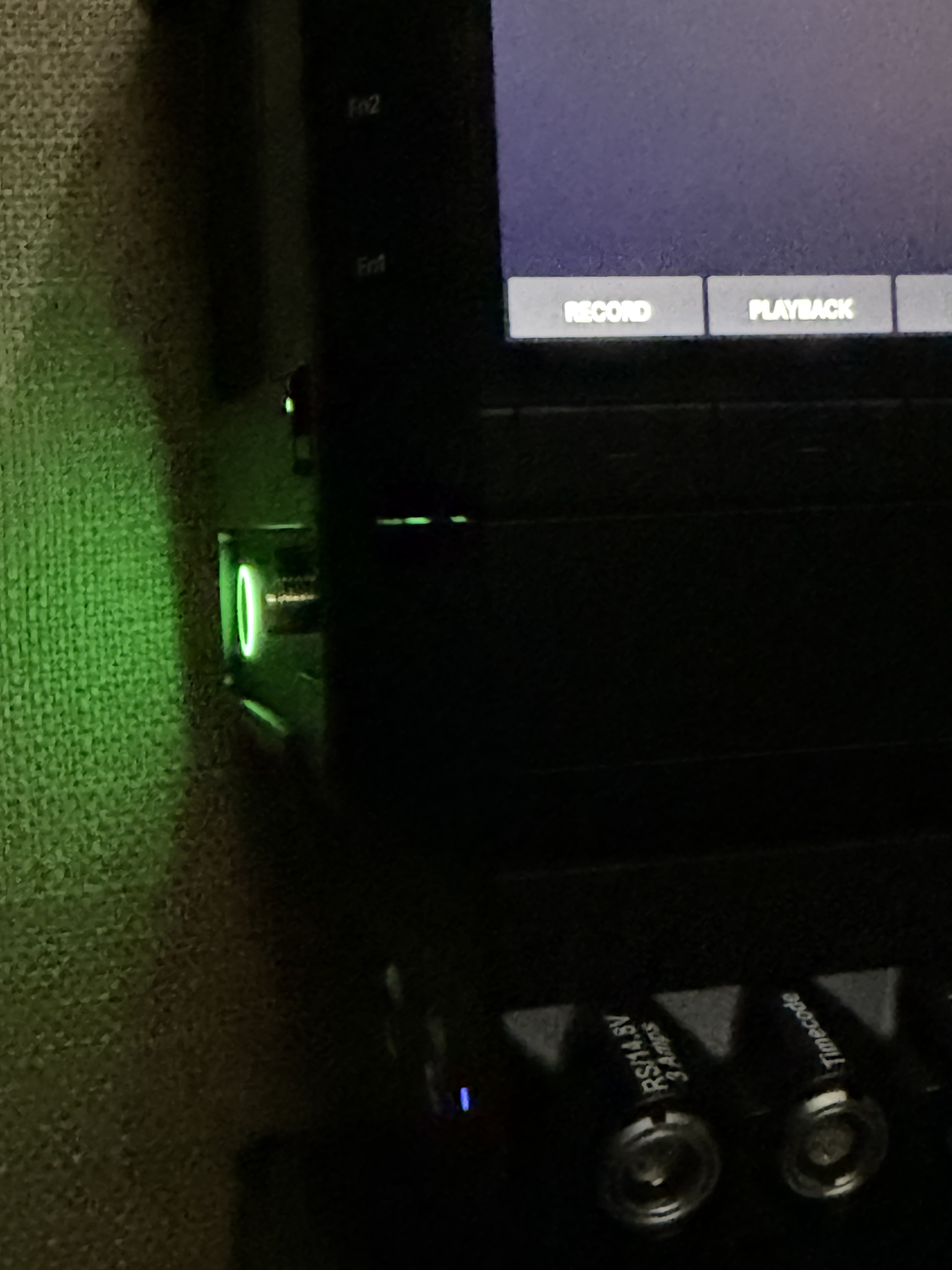

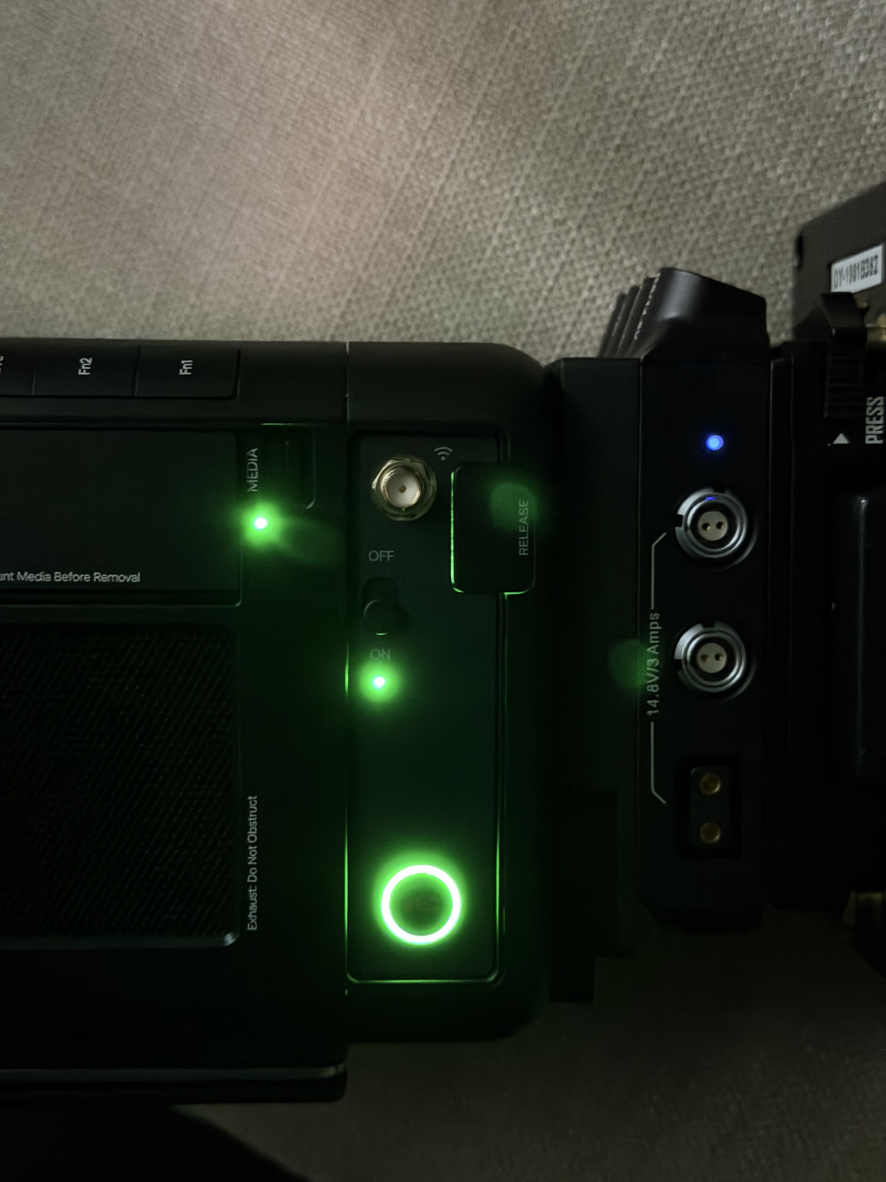

I have owned and rented out many cameras over my career and have been fortunate enough to have helped in the development of a couple of them. My opinions below stem from this history and knowledge.
Fit and finish:
  • There are a places on the camera body that suffer from light leak. You can see a green light shining through the cracks. I am not as upset about the light leak as I am about the potential water penetration. One of those spots is at the top of the camera. The other is the battery release button.
  • The depth of the V-Mount is non-standard. There is a 1.75mm gap when my adapters and batteries are seated that caused flexing and wiggle. I corrected this with soft-side Velcro but will have to look into a method for more reliable stability.

I could see the gap in your pictures, too. I think Mutiny is looking to address this with a locking plate like they did with the Komodo. I just wish Pixboom had spoken to people like us before locking in a few of the design decisions that were made.

I hadn’t noticed the light leak issue, so I’ll have to check my body. I agree that the light leak itself is probably insignificant, but the potential for water ingress is another matter entirely.

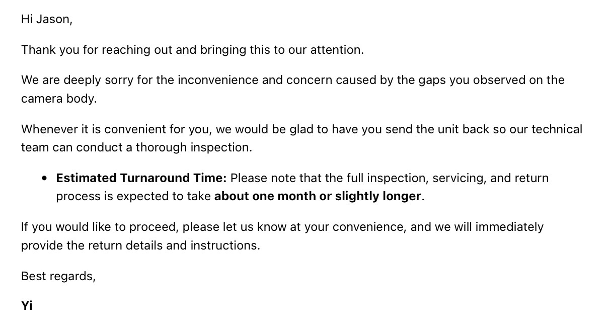

This is an unacceptable response given that the camera was shipped with defects. Waiting 1+ months for a repair on a brand new body is a highly unprofessional proposition.
Hi Jason — this is Jing.
You’re right, and I’m not going to defend what was sent. That response solved nothing for you.
It’s the weekend here, so I can’t dig into this properly today. But I will — first thing Monday. I want to understand exactly what happened and come back to you with something that actually makes sense for your situation.
Give me until then. I’m on it.:saluting_face:
