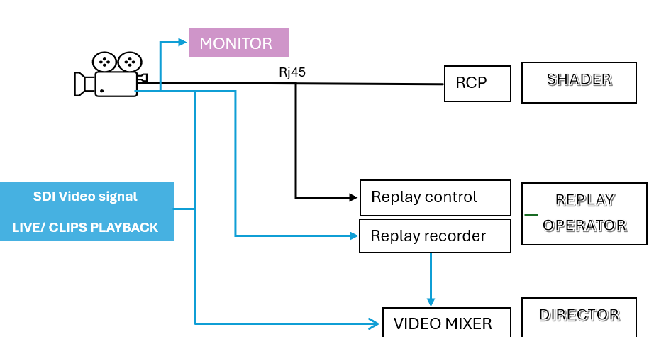

Yes, of course! One of the most critical parts of the live broadcast workflow is the unification of cameras in real time, i.e. all cameras have to have the same colourimetry and video levels. For this it is necessary to be able to control precisely and in real time the main parameters of the camera: colour temperature, black pedestal, shutter, LUT’s, multi-matrix and iris control (this last one depends on the lens…)
From a RCP, such Cyanview or skaarhoj, console or device where these parameters can be varied, the shader adjusts all the cameras in the same way.
Another important value would be to have two SDI video outputs, one for monitoring and one for live. But, for the moment, one is enough if you can switch Between live and playback clips. HDMI is not considered Broadcast…During live, director can put on air live signal, and also record one clip on camera. After the action, one replay operator trig the clip and play from the SSD on camera in slowmotion, recording this signal on the main replay machine. After that, he can play the clip in slow. Clips can be controlled from a normal device, such laptop or tablet, but camera must be controlled from RCP
