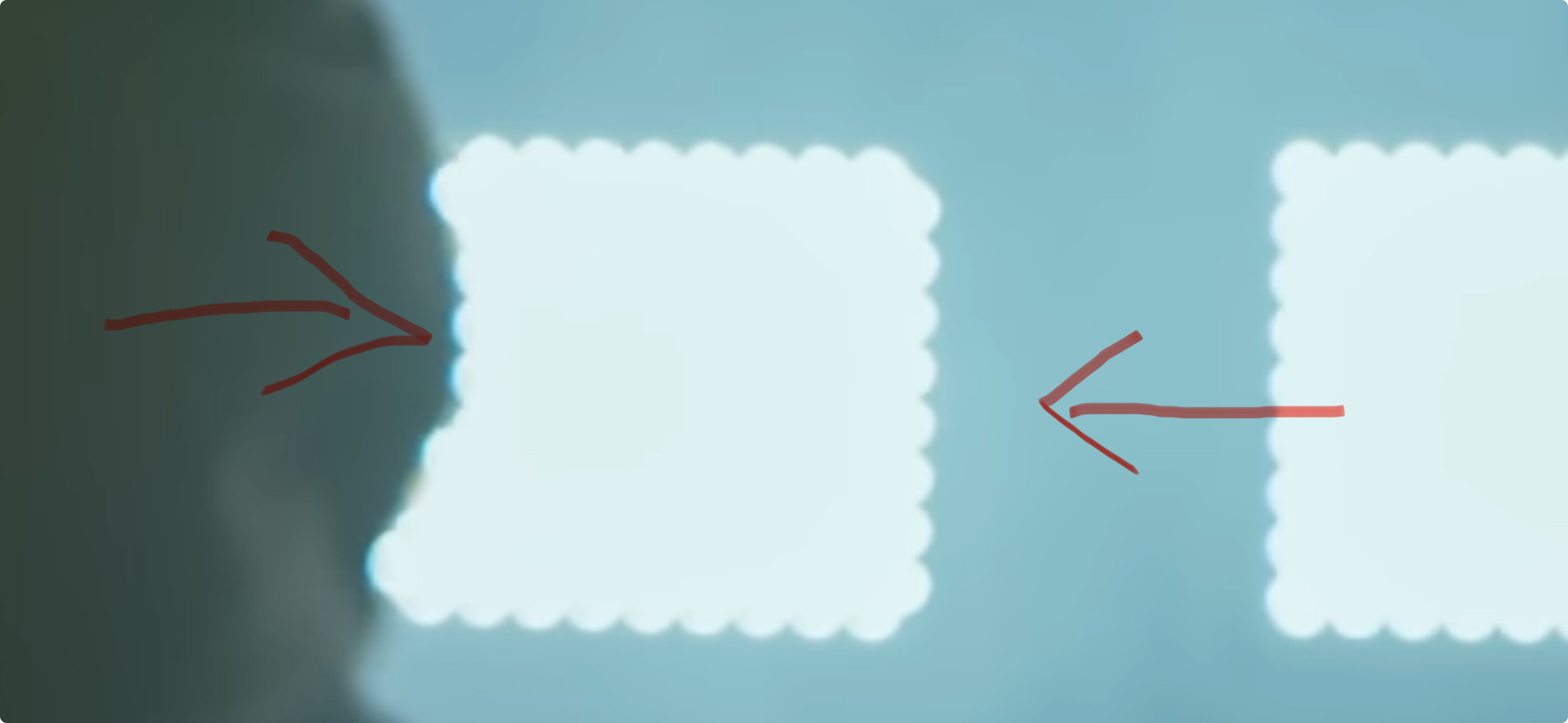

From 0:38-0:48
Its the shape of the light bulbs, brought back from clipping the sensor through the hard egde of the dark trousers, resulting in the big circle shape of the bulbs with cyan CA. Not the cameras fault in my opinion.

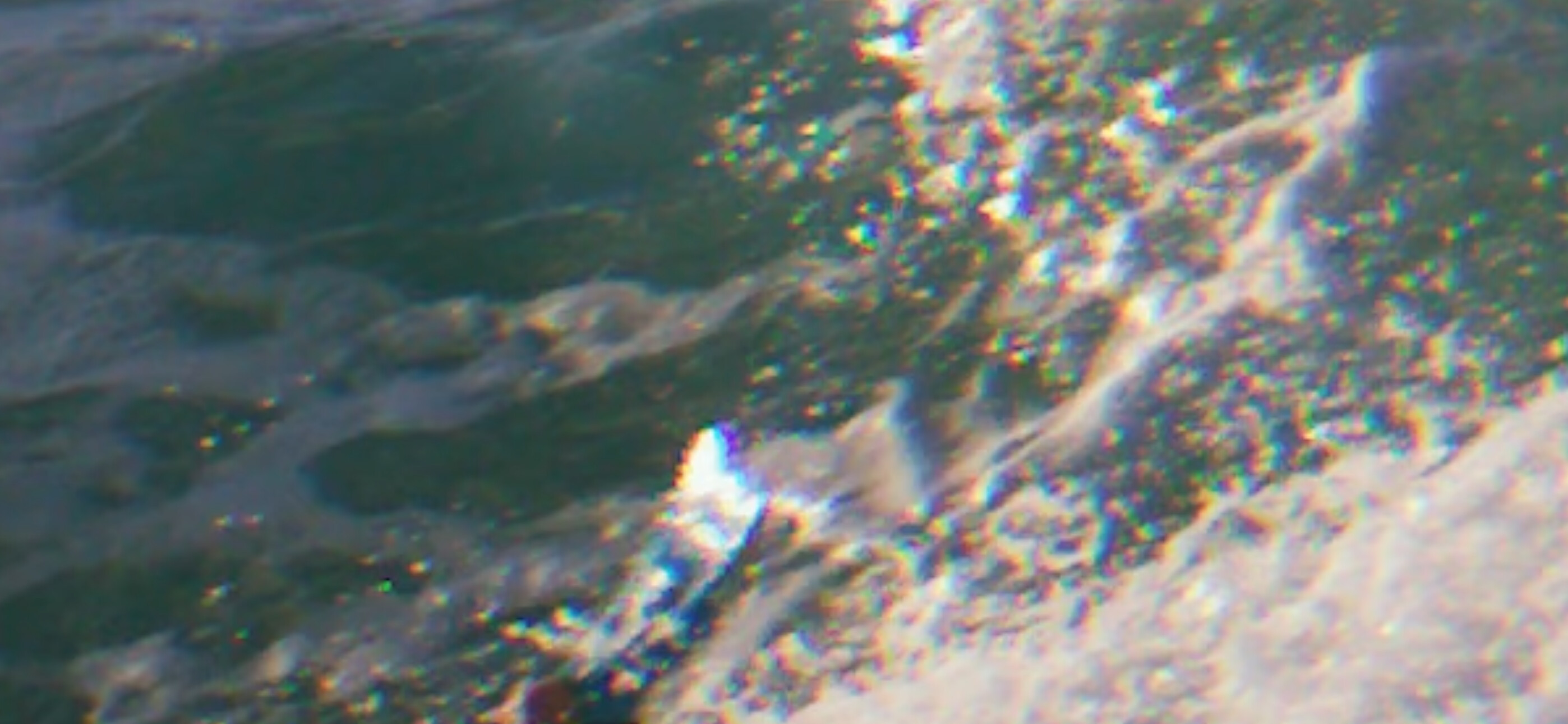

From 2:03-2:11
A special situation, where the sun coming from the left hits the water drops, and the drops function like a prism. Like seeing a rainbow. You get a lot of moving spectral colors, because the water drops are moving.
Thanks for pointing that out! I hope that’s it.
