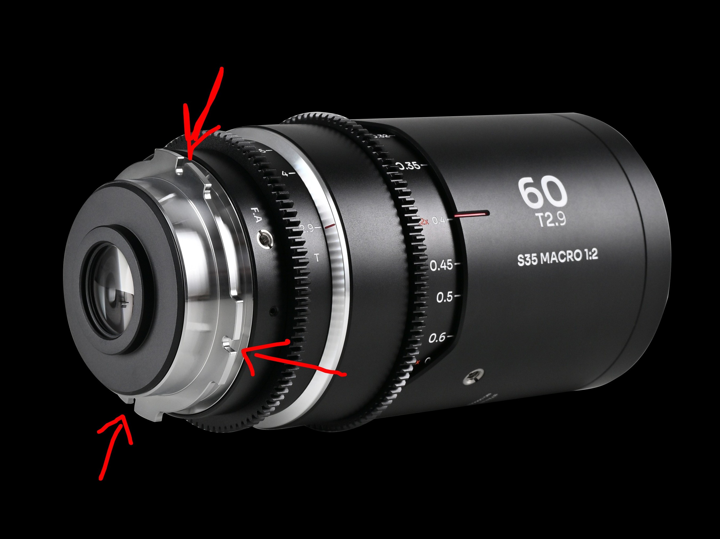

Is there a way to know if something like this:
Nanomorph 1.5X Anamorphic [60mm T2.9 Macro 1:2] - Laowa Cinema Lenses
Would work rotated 90deg on Spark?
Or that’s an email to laowa?
Most likely all my Sony lenses, hopefully we get auto focus in the futur. But also I can’t wait to mount a fisheye on this camera!!
Yes, that has pin slots on all the wings (I’m assuming the one we can’t see on the back side matches the rest, though it would still work fine even if it didn’t for some reason) so can rotate for vertical.
